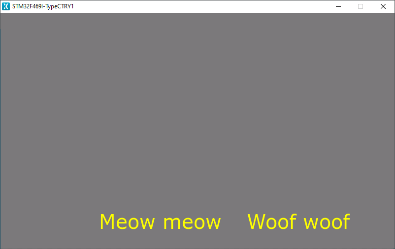

Next, we do the funny "Unicode::snprintf(testTextAreaBuffer, 10, "Meow meow");" This actually puts the string "Meow meow" into the buffer and adds termination character at the end so you don't have to worry about it. This function actually defines what TextArea shows. "10" is a buffer length. You can have a string of 1 character but have buffer length 10, the function will take care of it.
Then I decided to resize the TextArea, but you can set fixed width of course, it's all in TouchGFX documentation online. I just wanted to see all, since I'm doing proof of concept here.
Then I add textArea to the screen. It could very well be container1.add or something else.
And then invalidate() forces TouchGFX to redraw the widget to make it show up to date content of the buffer. If you want to change the content of TextArea, you do Unicode::snprintf(testTextAreaBuffer, 10, "New Text"); followed by invalidate().
The second TextArea does exactly the same; it has the same Resource but its own buffer array.
I have a semi-opaque background box on the screen, other than that, the result is the following:
Congrats, that's it!
