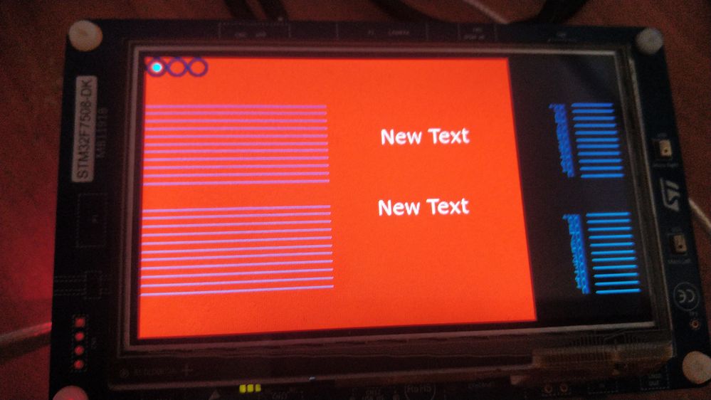

Hello ,
when i swap slowly from one screen to anotheir, i get stuck beetween two screen on my board (STM32F7508-DK)
I have attached a full the project.
