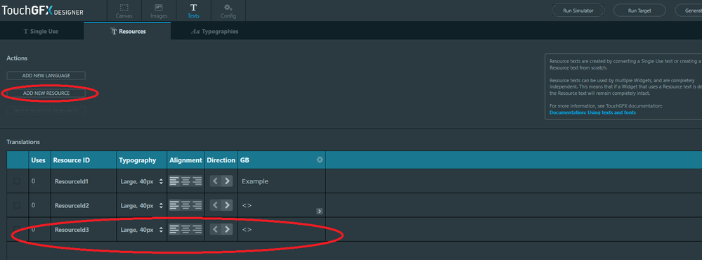

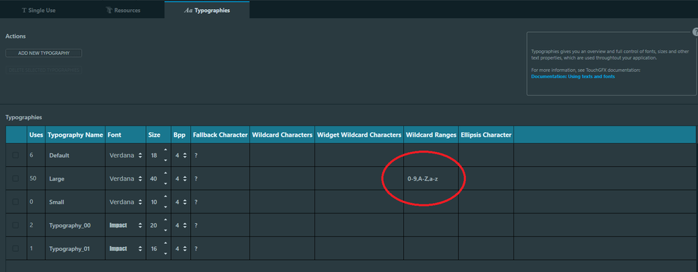

FULL SOLUTION TO CREATING CUSTOM TEXTAREA WITH CODE
With the help of everyone participating in this post and some other people in other threads (and, of course, my own undeniable genius *chuckle*), here is a summary of how you can create a textArea purely (99%) with code. Step by step from zero:
Open TouchGFX Designer. In the upper tabs, go to "Texts"->Typographies. Make sure there is a font you are going to use (or add another one), you need to generate letter glyphs using TouchGFX Designer. In my case, I did this:I'm using Verdana 40px font; In "Wildcard ranges" I have written 0-9,A-Z,a-z; this will force TouchGFX to generate glyphs for all letters and numbers even if no TextAreas created natively in TouchGFX Designer use them. Otherwise, you can miss a few letters of that font (and will see "?"). If you need other characters, such as commas and stuff, there is "wildcard characters" section for it.
Next, go to "Resources" tab. "Resource" is a set of formatting rules that we associate with every TextArea. Font size, font direction, Alignment and content. Add new resource to use with the new TextAreas that we will create with the code. You can use one Resource with multiple TextAreas. It's just a formatting feature, not the text itself. I am going to use "ResourceId3" for my custom TextAreas. Set the Typography of the Resource to the one you used in 1.In Resource text, write "<>" (means "wildcard"), If you write some text in there except "<>", it will be visible in all TextAreas using that resource. Wildcards, however, are individual for every TextArea. Personally, I want all TextAreas to have completely different content, so I do the following:
Now we have forced TouchGFX to generate all characters' glyphs for the font we're going to use and we have created text formatting rules, also known as Resource (Rules are: use that font with glyphs, align left, text direction left to right, text is entirely wildcard). So we finally get to generating stuff with the code.
Create the screen where you want to create your custom TextAreas. The screen can be empty, we just need the files for the screen to be generated to put our stuff into them. "Generate the code".

What's left is to actually add stuff to our NewScreen.cpp, which in my hands looks like this:
#include <gui/newscreen_screen/NewScreenView.hpp>
NewScreenView::NewScreenView()
void NewScreenView::setupScreen()
NewScreenViewBase::setupScreen();
//CREATING ONE TEXTAREA
testTextArea.setXY(200, 400);
testTextArea.setColor(touchgfx::Color::getColorFrom24BitRGB(255, 255, 0));
testTextArea.setLinespacing(0);
testTextArea.setWildcard(testTextAreaBuffer);
testTextArea.setTypedText(touchgfx::TypedText(T_RESOURCEID3));
Unicode::snprintf(testTextAreaBuffer, 10, "Meow meow");
testTextArea.resizeToCurrentText();
add(testTextArea);
testTextArea.invalidate();
//CREATING SECOND TEXTAREA with the same resource
testTextArea2.setXY(500, 400);
testTextArea2.setColor(touchgfx::Color::getColorFrom24BitRGB(255, 255, 0));
testTextArea2.setLinespacing(0);
testTextArea2.setWildcard(testTextAreaBuffer2);
testTextArea2.setTypedText(touchgfx::TypedText(T_RESOURCEID3)); //Same resource as the first TextArea. EXPERIMENT!
Unicode::snprintf(testTextAreaBuffer2, 10, "Woof woof");
testTextArea2.resizeToCurrentText();
add(testTextArea2);
testTextArea2.invalidate();

Also you need to add all characters you are going to use with this font to Texts / Typographies otherwise you will get string of "?" (fallback characters)
