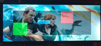

Hello
I'm an amateur Touchgfx user.
I've completed many challenging tasks with Touchgfx, but I need a very simple one.
I want to set the output port high for the duration of a keystroke.
I used the ClickListener instructions in the program, but they didn't work.
I tried creating Box1 the same way and it works perfectly.
With this code, it works while I hold the button down, and stops when I release it, just as I wanted.
void BRHZLView::boxClickHandler( const Box& b, const ClickEvent& evt)
if (evt.getType() == ClickEvent::PRESSED) {
HAL_GPIO_WritePin(GPIOG, BZR_Pin, GPIO_PIN_SET);
HAL_GPIO_WritePin(GPIOB, PST_I_Pin, GPIO_PIN_SET);
} else if(evt.getType() == ClickEvent::RELEASED){
HAL_GPIO_WritePin(GPIOG, BZR_Pin, GPIO_PIN_RESET);
HAL_GPIO_WritePin(GPIOB, PST_I_Pin, GPIO_PIN_RESET);
But the flexbutton group keeps giving definition errors, and the program won't compile.
I'm using Stm32h7b3i Evk, and the definitions in the base file don't match the definitions at https://support.touchgfx.com/docs/development/ui-development/touchgfx-engine-features/mixins.
The program gives an error.
Could you please provide a link to a sample program?
