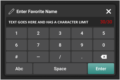

I'm looking to implement a character limit on a keyboard, as seen by the red 30/30 text in the screen below.

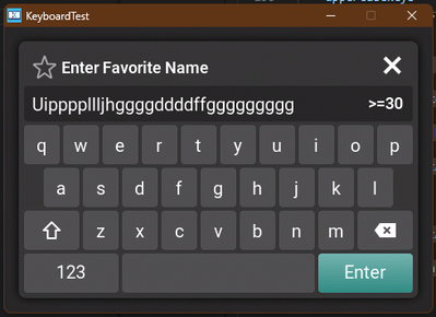

I tried adding some logic that conditionally determines which TypedText to display in the textArea, and that works fine.

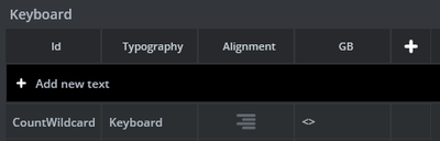

I identified my mistake - even if you're ONLY setting dynamic text, you still need to create a TypedText with the contents `<>`
and set that TypedText for the text area...

keyCountTextArea.setTypedText(TypedText(T_COUNTWILDCARD));The rest of the code was left as-is, and it worked!
