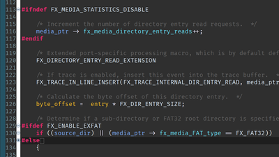

The offending code seems to start here:
Maybe it's related to media statistics. And AFAIK it's free space evaluation, number of files and that sort of thing. Maybe it's broken? IDK, I'll just try to disable and see what will happen. I noticed that my tests use to pass when performed on empty media, and crash when I add some files to them (I just copy a bunch of my sources for testing).
BTW, my crash occur on `fileExists` function, so it shouldn't even need much memory to complete, just a few sectors for directory entries. I'm sure it uses more than one. One is needed for the parent directory, one for the candidate (it must load an entry to test if it matches). Then it returns the found entry, so at least 3 are needed to perform the search. But it's just theory.

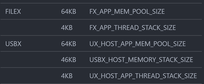

BTW, here's my memory setup:
