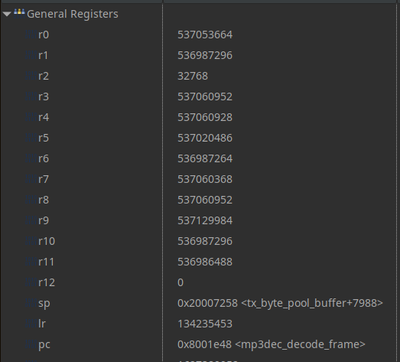

See , here is the debug at starting the function:

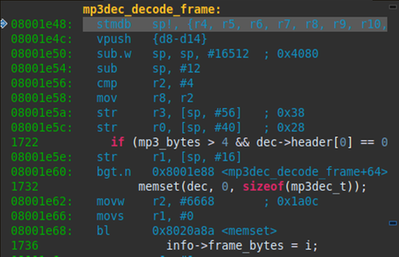

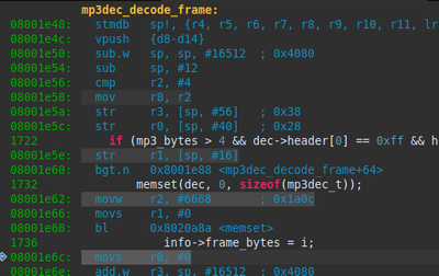

disassm shows here:
(i see no problem...) stack is in mem:
and this seem ok:
so: how to find the reason for this hard fault ?

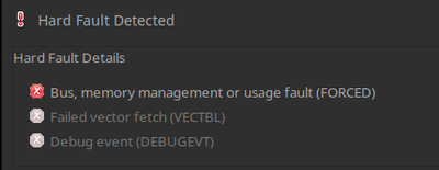

next step ...hard fault :
cpu then:

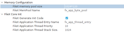

+ give filex more space, 20K -> 120K ...but changes nothing.

The above assembler, starting with STMDB and using the stack pointer, that's where it instantly fails?
I guess you already checked stack size and location in the linker file? Especially after increasing stack and heap?

here (now) at decoder start:
thread info:
cpu:
I am at a loss . looks all ok for me...
UNTIL THE NEXT STEP ! then hard fault - not even in assembler one step to the function...
2023-12-08 5:16 AM
just a funny idea : can i jump to other position in this function?
ok, i moved cursor down 3 lines and set (menu)run -> move to line , then single step ... no problem !
so the problem is the first instruction - right?
from ARM ...: >>
Store Multiple Decrement Before (Store Multiple Full Descending) stores multiple registers to sequential memory locations using an address from a base register. The sequential memory locations end just below this address, and the address of the first of those locations can optionally be written back to the base register.
how can this generate a hard fault, if SP is middle in the "byte pool" ???
2023-12-08 6:26 AM
Tesla and Jan already told you that the VPUSH instruction is pushing double floating point registers and therefore the code is compiled for double sized FPU devices. Jan also asked whether you are compiling that module yourself or using an already compiled library.
2023-12-08 7:16 AM
sorry, i forgot to write: compile from source.
compiler setting should be ok:
and vpush - can be with single or double floats , as i read this:
| <sreglist> | Is the list of consecutively numbered 32-bit SIMD&FP registers to be transferred. The first register in the list is encoded in "Vd:D", and "imm8" is set to the number of registers in the list. The list must contain at least one register. |
| <dreglist> | Is the list of consecutively numbered 64-bit SIMD&FP registers to be transferred. The first register in the list is encoded in "D:Vd", and "imm8" is set to twice the number of registers in the list. The list must contain at least one register, and must not contain more than 16 registers. |

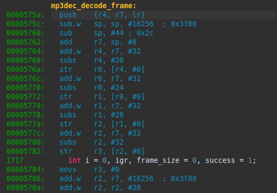

but : i tried -as i wrote- also with software float - but same : hard fault at stmdb instruction.

In this post above @AScha.3 showed non-FPU version of the code which fails too; so the problem is probably not the FPU.
(I'm also not sure whether VPUSH of double registers is not implemented also in SP FPU, but that's another discussion).
This processor is Cortex M33, i.e. "secure"; can't the issue be related somehow? I know nothing about it as I hate reading ARM's litanies, but can't e.g. a piece of code be forbidden from accessing some RAM area, e.g. the place where stack is?
Aren't there more fault-related registers containing more details?

Jan, about "secure" (i hated also, to even read about it) i tried to avoid anything to activate. But ...who knows.

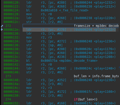

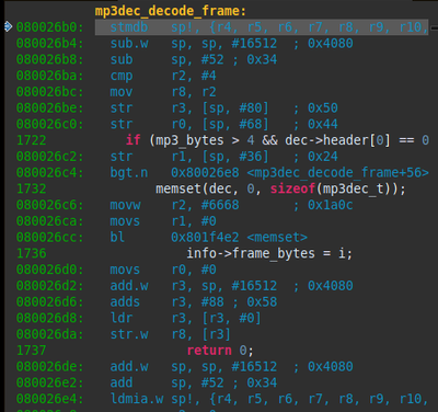

because end of my logic...i just tried to change the code by using no optimizer (-O)
and surprise: the mp3decode() is no more reached, hard fault before/or at jumping :
this is last position, next step -> hard fault.
and here , where he should go : to mp3decode , now without any vpush . :)
but same fpu in hardware setting.
