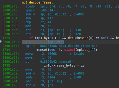

when this function ( mp3dec_decode_frame(..) ) is used, get hard fault. ok, but cannot debug , because no step into function is possible, hard fault is always next step.
Now the prerequisites : this function i used to decode MP3 in my H743 project, no problems.
then copied to this H563 project, but now using rtos Azure (because forced to use this by STM)…
and now : not working anymore, even cannot debug, what happens there, because first is : jump to hard fault.
So maybe the stack is in nirwana, but i cannot see (understand ARM assembler) anything, that leads me to solve the problem.
See , here is the debug at starting the function:
disassm shows here:
(i see no problem...) stack is in mem:
and this seem ok:
so: how to find the reason for this hard fault ?
next step ...hard fault :
cpu then:

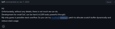

so had the idea: maybe i am not the first to get this problem with the mp3-decoder, look at "issues" on git ;
and i found a comment:
so it seems to need much room on stack - i set the thread to 24KB stack, just to check.
then : no hard fault and ThreadX stack statistics show now (!) : about 23K stack used !

Indeed even your initial code allocates ~17 KB of stack space in that function:
sub.w sp, sp, #17280 ; 0x4380
If it is not done directly in the code of that function, it is a result of function inlining done by compiler optimization.

but still i dont understand: on single step, who generates hard fault at the first instruction , where just some pointers are pushed to the stack ?
and even the stack gets too big, it just would "kill" some other memory (for usb stack..) - so how or who calls hard fault here? is it the rtos ?

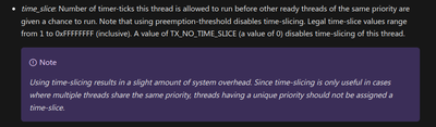

TreadX can use time-slice/task switching - just as initial setting is, it dont do it.
Thats why in first simple test it didnt work.
I had to read first how to set it:
https://learn.microsoft.com/en-us/azure/rtos/threadx/chapter4#tx_thread_create
