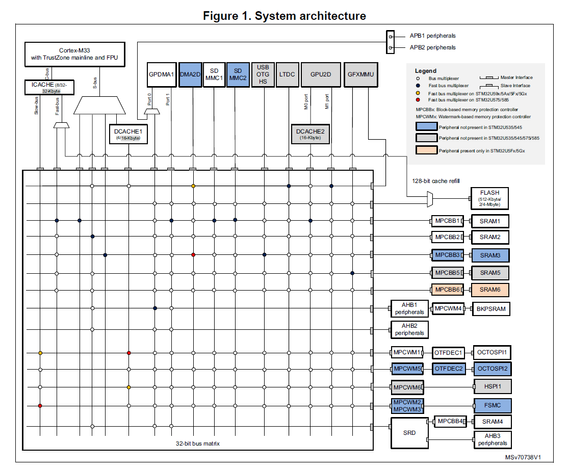

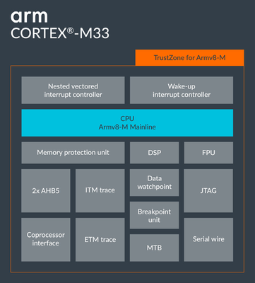

ICACHE, DCACHE1 and DCACHE2 are ST IPs, not part of the CM33. Refer to figures below from Arm Cortex-M33 Processor Datasheet and STM32U599 RM0456.
They are memory mapped as any other STM32 peripherals in stm32u5a9xx.h as follow:
#define ICACHE_BASE_NS (AHB1PERIPH_BASE_NS + 0x10400UL)
#define DCACHE1_BASE_NS (AHB1PERIPH_BASE_NS + 0x11400UL)
#define DCACHE2_BASE_NS (AHB1PERIPH_BASE_NS + 0x11800UL)
They are managed by stm32u5xx_hal_dcache.c and stm32u5xx_hal_icache.c drivers in ~/STM32U5xx_HAL_Driver.
