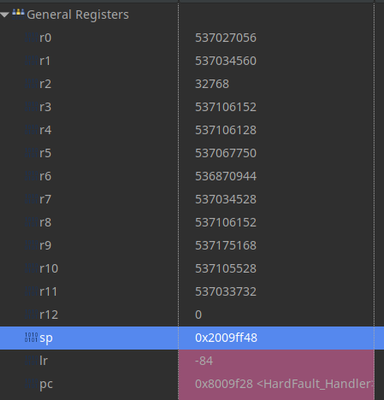

See , here is the debug at starting the function:
disassm shows here:
(i see no problem...) stack is in mem:
and this seem ok:

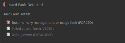

so: how to find the reason for this hard fault ?
next step ...hard fault :
cpu then:

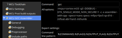

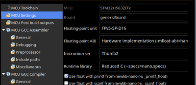

2023-12-07 2:40 PM
Is the floating-point coprocessor enabled?

I have similar experience with Hard Faults. In my case I just allocated a bigger memory pool for the component and it worked. So the library I used (FILEX) probably had a bug with some out of bounds writes. In a perfect world it should crash into a nice spin loop showing you exactly where it could not write data. And when you have the stack frame overwritten - no debugging for you. That's probably the kind of bug where the data goes where it should not go. The common symptom of this is debugging showing nothing or just some random garbage that makes no sense.
2023-12-07 9:04 PM
Looks like it might depend on the double precision FPU-D of the H7. Perhaps use library from CM4F part or F74x core with FPU-S

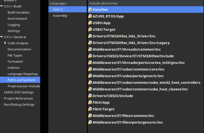

paths seem ok:

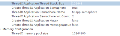

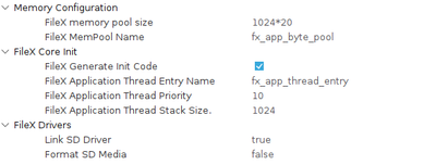

@HTD , right, i also had suspicions against Azure - stack, memory management - and increased values:
8K stack, 100K mem
but not in filex, because this seems (!!!) working fine.
still have 300K ram free, so i try with more mem for filex thread - as you suggest.
2023-12-08 12:16 AM
As @Tesla DeLorean said above, from disasm (vpush of double registers) it appears that the library uses double-precision FPU which is not available in Cortex M33/'H5. I'm not versed enough to tell if vpush of double is indeed dependent on presence of the double-precision FPU, but, just another question to the many: do you compile that library from sources, or does it come as a precompiled .a?
Also, I'm not sure the -fpu setting guarantees the FPU to be switched on. IIRC in the Cube infrastructure, compilation of the couple of instruction needed to switch it on depends on some specific preprocessor symbols to be present - see startup code or functions called from there for relevant details.
