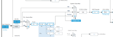

Use this configuration over PLL with a crystal in the allowed range of HSE input:

Put in the 25M clk , HSE bypass setting, then use internal PLL to get 100M core speed.

"I want to feed this clock directly to the HSE input of my STM32G431CBU in order to achieve a 100MHz HCLK clock, which should be ok given that the maximum acceptable frequency is 170MHz."
