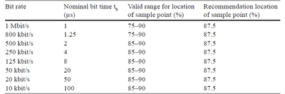

2.1 The sample point position depends on the bitrate:

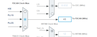

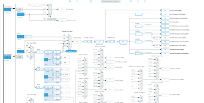

I am using 12MHz SYSCLK and 40MHz for FDCAN. Is it too low?
I have to make it low as possible for low power consumption. (but I can't change MCU for low power.)
Therefore, If there is clock under limitation for system clock frequency, please let me know the minimum system clock frequency for CAN communication.
Thank you again.
