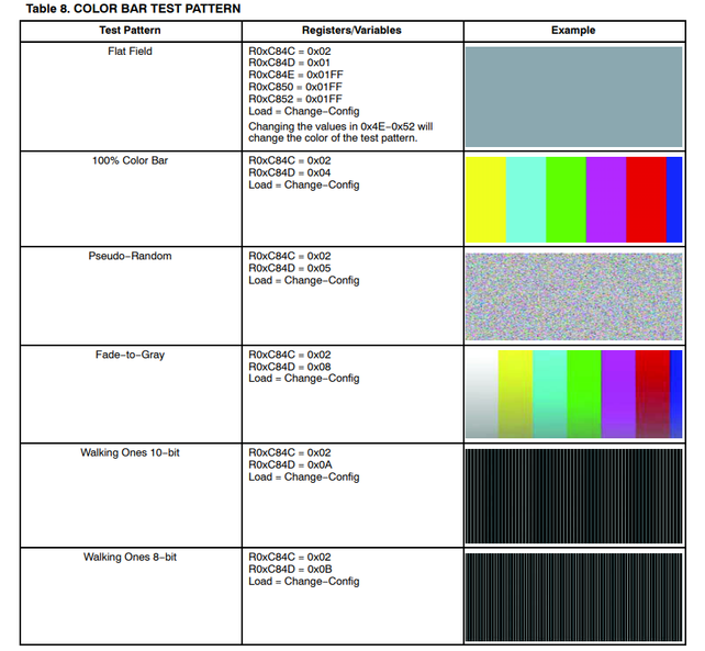

Now i am trying to print some patterns which are sensor supported like below image.
I configured FLAT field pattern(register values) through I2C in specific register. And reading again through I2C from pattern register, got same value which i configured. So which means pattern is configured properly.

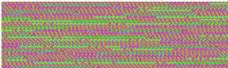

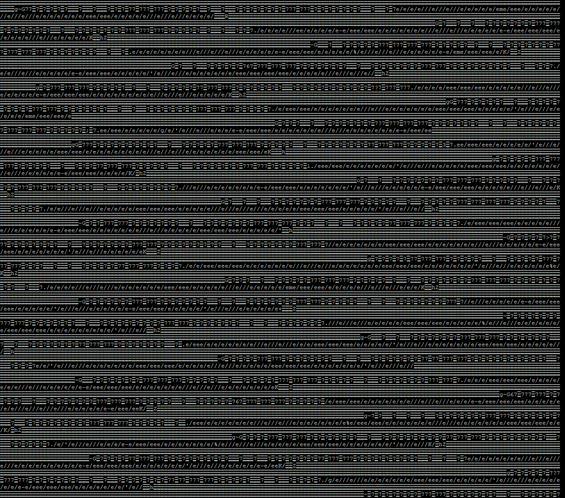

At present i'm getting DCMI Data like below image. This below image is screen shot of DCMI data in putty terminal.
By using this RGB to Image converter "" https://codestation.ch/ "" result as like below. I'm unable to get Exact pattern which i expected.
Can anyone help on this issue , if i made anything wrong on DCMI part.

Hello @Naveen_N and welcome to the Community,
Is the cache enabled? If yes try to disabled.
Try to send for "hello world" first via serial before sending the image.
I recommend you to look to this post and to AN5020 precisely section 8 DCMI application examples may help you.

2025-01-21 7:09 AM
How on earth is this going to work? You've got no synchronization, the DMA functions return immediately, and then you clear the buffer. Not to mention the DCMI is continuous, and there's a huge disparity in the input vs output rates.
