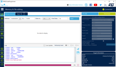

Hello, I am having an issue turning off trustzone on my device. While checking that the example project to blink the LEDs was properly working on my device (it wasn't, it kept getting secure faults.) I had gone into the STM32 Programmer to change some options to see if it would fix anything in regard to why I kept getting secure fault errors on my device. I accidentally locked WP1A and WP1B. Then I attempted to fix this by turning on and off the trusted level. Now I am stuck with WP1A and WP1B locked, trustzone enabled, and my RDP stuck at 55.

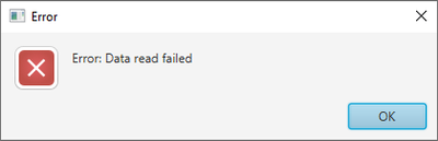

2024-02-13 10:30 AM
I am in this same situation on a STM32U575. When I try and connect to the device in Hot Plug Mode as described, I get the following error:
