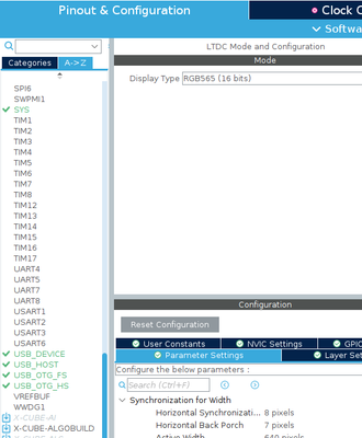

I tried to have LTDC and both USB , no problem to see:
I am on IDE 1.13.1 .
