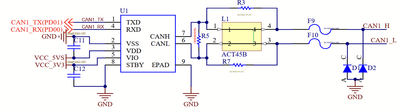

1- The link you provided for that DMMC board doesn't contain anything moreover it is in Chinese language. So please provide the schematics of that board.
2- I'm not comfortable with that Chinese transceiver: SIT1042 are you sure it's a good product?

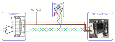

2025-05-26 3:04 AM
Sometimes it is only the lacking termination resistor.
> I am able to drive the stepmotor controller with my computer by using python-can through the CAN USB device, which indicates that for the most part my wiring seems okay, and that I do have a somewhat working CAN network.
I don't know what 'device' you talk about here, but do you have some bus monitoring software, and if so, can it detect and display error conditions ?

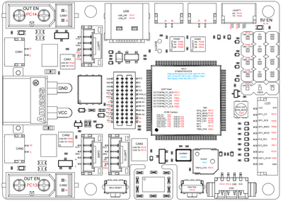

Unfortunately, I could not find non Chinese documentation, please find attached the datasheet of the board, and here are a few relevant schematics:
I am trying to the the pin on the top left corner (next to OUT EN PC14), and please note that U1 here is made of the SIT1042.
Well to be honest I cannot say since it is built-in, but I expect it to work because it seems that that board was used for CAN in some projects. You may find attached its english datasheet here: https://semic-boutique.com/wp-content/uploads/2016/05/SIT1042.pdf

So I am able to send CAN messages and receive answers from the CAN USB device to the Stepper motor controller, from my understanding it indicates that the electronics setup (such as terminal resistor values) should be good.
Now, my issue is to have the STM32 based board use this CAN setup.
I have made a schematics of for the bus (I changed the DMMC02 connector but it is similar with CAN1).

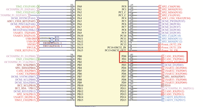

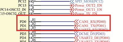

2025-05-26 6:46 AM - edited 2025-05-26 6:49 AM
According to your ioc file, you mapped FDCAN1 on PA11 and PA12 while in the schematic, FDCAN1 is mapped on PD0 and PD1.
So please check this issue before going ahead: need to change FDCAN1 pinouts in the CubeMx.
2025-05-26 8:31 PM - edited 2025-05-26 9:24 PM
Thank you for pointing out the pin issue, I forgot to update them after changing port. You may find attached the new .ioc file.
Unfortunately, as before changing the port, there is still something missing somewhere. Please see my answer to Ozone for updated details.

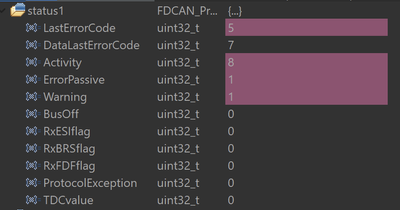

2025-05-26 8:52 PM - edited 2025-05-26 8:54 PM
Thank you very much for your advice !
While I could not find a CAN monitoring software that allows peeking at the CAN error values compatible with the CANable CAN USB device, I was able to retrieve bus-related info directly using the HAL libraries.
I have applied the pin fix pointed out by mƎALLEm,and then changed my wait loop to this:
while(HAL_FDCAN_IsTxBufferMessagePending(&hfdcan1, FDCAN_TX_BUFFER0) == 1) {
FDCAN_ProtocolStatusTypeDef status1;
HAL_FDCAN_GetProtocolStatus(&hfdcan1, &status1);
__NOP();

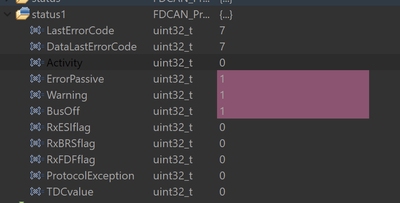

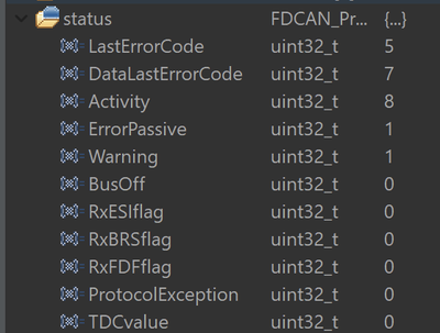

Since the pin fix, the program is not stuck in the while loop right away so there is definitely something going on, this is the state of status in the first iterations
(Note: "1 iteration" = "1 send attempt" = HAL_FDCAN_AddMessageToTxBuffer + HAL_FDCAN_EnableTxBufferRequest + HAL_FDCAN_IsTxBufferMessagePending) :
LastErrorCode=5 : Bit 0 (dominant) error
DataLastErrorCode=7 : No change since last read
Activity=8 : Node is neither receiver nor transmitter
ErrorPassive=1 : Passive state
Warning=1 : at least one of error counters has reached the Error_Warning limit of 96
, and then after more iterations, the program gets stuck in the while loop waiting for transmission, here is the value of status
As you did anticipate, the setup seems to indeed fail to transmit and accumulate error, leading to error-passive and bus-off states. I also did confirm with a quick setup that when the STM32 is asked to send a CAN message, no signal can be seen on the bus.
[...] but a CAN message is not considerated sent until an ack from a receiving node is detected. I think there is no successful transmission at all from the STM32 side.
I understand that it seems that something is wrong, leading to the STM32 being unable to send any message. I did multiple checks of my wiring and I cannot find issues here.
2025-05-26 10:55 PM
I think the default setting for the error passive count is 128, while each failed attempt increases the count by (I think) 8. When the count reaches the "bus off" count (default 255), the node turns off for some time.
In absence of specific tools, I would recommend to disconnect the working nodes (the USB-CAN device and the motor controller) from the bus and only connect a termination resistor. Then capture a transmission from the STM32 with a scope (or a logic analyzer which can be configured to the CAN levels). Compare the signal to that of a proper / working transmission.
Either the transceiver hardware on the STM board is the issue, or the CAN bus settings of the STM32 itself are not correct.
If that is possible, you can try to connect the STM32 CAN Tx/Rx pins directly to the respective CAN Tx/Rx pins of the motor controller, and see if that works.

When using normal mode, as before nothing happens. Here again, reading the status with HAL_FDCAN_GetProtocolStatus(&hfdcan1, &status1); gives:
with Activity=8 : Node is neither receiver nor transmitter.
