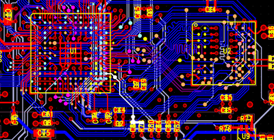

Are all of the power pins decoupled with a 0.1 uF close to the chip? Can you share a photo or schematic?
Are the misbehaving EXTI traces in close proximity to FMC traces?

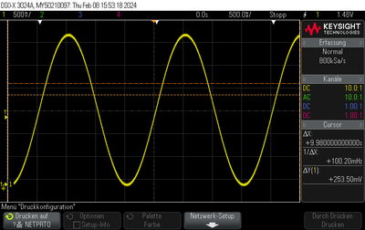

2024-02-08 6:38 AM - edited 2024-02-08 7:40 AM
Hello TDK,
thank you for your reply, yes, power pins are decoupled with capacitors.
the white one is one of the affected EXTI-Pins. The other chip on the right side, is the RAM. In my opinion there cannot be lot of interference by the FMC-Traces.
I checked the trace with my scope, measured the testpoint directly near at the STM.
for sure, this picture is very low horizontal resolution, but also in other resolution, there are no glitches or noise present on this trace.

2024-02-08 10:31 PM - edited 2024-02-09 12:26 AM
Bob S,
sorry, i think speeding up the ramp will just reduce the vulnerable time window and lower the probability of the issue, but not solve it in the root case, this is not the solution i prefer.
In my case, as you can see in the screen shot above, every power line is C-coupled properly, alone in the showed area around the mcu, there are about 15 pcs. 100nF Caps on 3V3. And if the issues are mcu internal and can not be solved by better filtering of the 3V3 (or by other solutions, of course), the STM32H7 is not usable in my application.
Yes, i can generate a square wave, but as mentioned above, i want to solve/identify the problem, not only make an workaround. That is essential for me in this phase of evaluating different mcu vendors.
Using the EXTI for the buttons now, is just for evaluation purpose, in future it should be used to synchronize an other FPGA, so a perfectly working EXTI is highest priority in this application.
