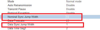

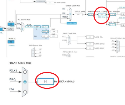

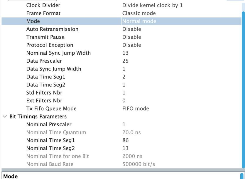

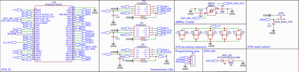

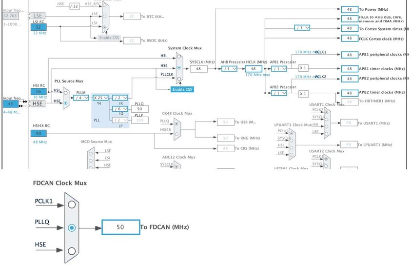

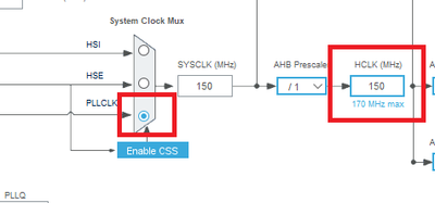

We’re currently developing an OBD reader using an STM32G473, which includes three FDCAN controllers. Each FDCAN interface is connected to a TCAN3413 transceiver.
As part of our testing setup, we built an ECU simulator using an Arduino with an MCP2515 controller and a TJA1050 transceiver, and this simulator works perfectly.

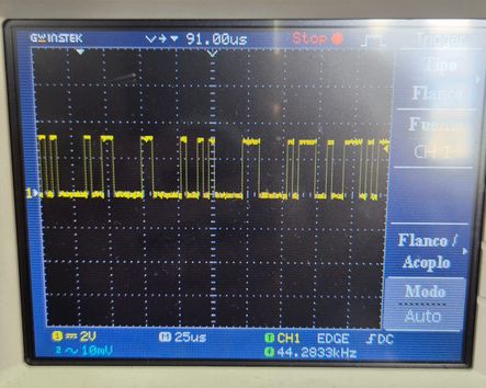

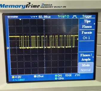

However, we’re facing a major issue when trying to send CAN requests from our STM32-based board to this ECU simulator. We’re not able to make the FDCAN controller operate in Classical CAN 2.0 mode and send messages correctly.
We verified this by checking both the RX and CAN lines of the transceiver with an oscilloscope. The TX signal from the STM32 does not show the expected data pattern.
That said, the transceiver itself is working correctly, when we send data from the Arduino node, the RX pin on the transceiver shows a clean, valid CAN signal. The issue seems to be that the STM32’s FDCAN controller doesn’t properly interpret or transmit standard CAN 2.0 frames, and as a result, we can’t see any valid messages on the microcontroller side.
To make it easier to understand our setup, we’re attaching several images:
We’d really appreciate any help or insight from the community on how to correctly configure the FDCAN peripheral on the STM32G473 to work in standard CAN 2.0 mode, compatible with MCP2515-based nodes.
Thanks in advance for any advice or configuration examples you can share!

HAL_PWREx_ControlVoltageScaling(PWR_REGULATOR_VOLTAGE_SCALE1);
RCC_OscInitStruct.PLL.PLLM = RCC_PLLM_DIV4;
RCC_OscInitStruct.PLL.PLLN = 25;
RCC_OscInitStruct.PLL.PLLP = RCC_PLLP_DIV2;
RCC_OscInitStruct.PLL.PLLQ = RCC_PLLQ_DIV6;
RCC_OscInitStruct.PLL.PLLR = RCC_PLLR_DIV2;
Error_Handler();
RCC_ClkInitStruct.SYSCLKSource = RCC_SYSCLKSOURCE_HSE;
RCC_ClkInitStruct.APB2CLKDivider = RCC_HCLK_DIV1;
if (HAL_RCC_ClockConfig(&RCC_ClkInitStruct, FLASH_LATENCY_1) != HAL_OK)
Error_Handler();

2025-10-15 3:28 PM - edited 2025-10-15 3:29 PM
Hello @Onlywavesmdp and welcome to the ST community
1- Please attach your ioc file
2- You need also to share the schematics
3- Did you try the External Loopback mode?
2025-10-15 3:41 PM
Question: why FDCAN clock > System clock frequency?
Increase the system clock. Let's say the max frequency at 170MHz using the PLL and keep the FDCAN clock set at 50MHz.
2025-10-15 6:41 PM - edited 2025-10-15 6:44 PM

isbadioc=falseI’m also including the schematic of the board. Both the EQ simulator made with Arduino and the development board itself have a 120 Ω termination resistor connected.
In this case, even though the 120 Ω resistor doesn’t appear in the schematic, it is connected in parallel between CAN H and CAN L.
The transceiver configuration and its connection to the STM were made according to the specifications described in their respective datasheets. The standby/mode pins have their corresponding logic levels set so that the transceiver operates correctly. The 3.3 V supply for the STM is provided directly by the ST-Link programmer.
Regarding your question about the external loopback mode: yes, we tested it using the same code. In our code, a red LED on the board turns on whenever a valid frame is received. When we run the system in external loopback mode, that red LED keeps blinking constantly, indicating that frames are being received correctly.
However, since external loopback mode allows us to observe the signal from the controller’s TX pin, we connected the oscilloscope and noticed that the waveform looks quite odd compared to when we send a CAN frame from the EQ simulator. The CAN signal we observe at the transceiver’s RX pin is completely different in timing compared to the signal seen at the TX pin when using external loopback mode.
As for the FDCAN clock frequency in relation to the system clock frequency, that was just part of our testing. We tried multiple frequency values, some lower than the system clock. For example, we tested the FDCAN clock at 8 MHz while the system clock was at 48 MHz, but the system still didn’t work.
Thanks a lot for your quick reply and for taking the time to help!
2025-10-16 2:01 AM - edited 2025-10-16 3:22 AM
1 In next time please attach the ioc file instead of copying its content.
Second,
2- As I understood from the statement above the Loopback mode is working but having strange behavior on Tx pin.
What kind of oddity you have observed? Please post an oscilloscope screenshot.
3- Please change the system clock to be clocked from the PLL as the following:
So the system clock frequency is at 150MHz.
4- You said "The standby/mode pins have their corresponding logic levels set so that the transceiver operates correctly." Do you confirm you pulled low the STB pin of the transceiver by the MCU GPIO?
5- On which FDCAN instance you are observing the behavior?
2025-10-16 12:22 PM
Hi @mƎALLEm , i also configured the system clock as you suggested earlier, using the external 48 MHz HSE crystal and the FDCAN clock remains at 50 MHz.
Additionally, I’m attaching the oscilloscope captures we obtained from the TX pin when the FDCAN 1 is set to external loopback mode.
For comparison, I’m also attaching the signal observed on the transceiver’s RX pin when the ECU simulator sends data through the CAN bus.
This capture is mainly to emphasize what I mentioned earlier — the waveform has correct amplitude levels, but from a timing point of view, it does not look right.
In the code we are using, both FDCAN1 and FDCAN2 controllers are configured. The external loopback mode was applied to FDCAN1.
2025-10-16 12:37 PM
Here you didn't mention what System clock you set.. 150MHz?
For the screenshots are not clear to me. I cannot see nothing weird. What kind of comparison we need to do between both screenshots? are both showing the same exact frame with different timing or what?
Do you have a CAN analyzer? better to use a CAN analyzer.
To me what you have to see:
On CAN Tx from STM32 side, the frame sent. On the Tx pin of ECU, you need to see an acknowledgement bit.
So what you have to do is to show on the oscilloscope on the same screenshor using two oscillo channels:
1- CAN Tx pin of STM32
2- CAN_Tx pin of that ECU.
See how to analyze the CAN frame in this article / especially the section: 3.3 Discussion on the captured CAN frames.

Your bit timing doesn't look correct. Typically SJW should be 1 but you have 13. Not sure how that is possible as CubeMX doesn't have the option to change the SJW.
Try these values with FDCAN clock at 50MHz
2025-10-17 12:55 AM - edited 2025-10-17 12:56 AM
NSJW and DSJW are configurable in CubeMx
2025-10-17 3:30 AM
Discussion continuation here regarding this point.
