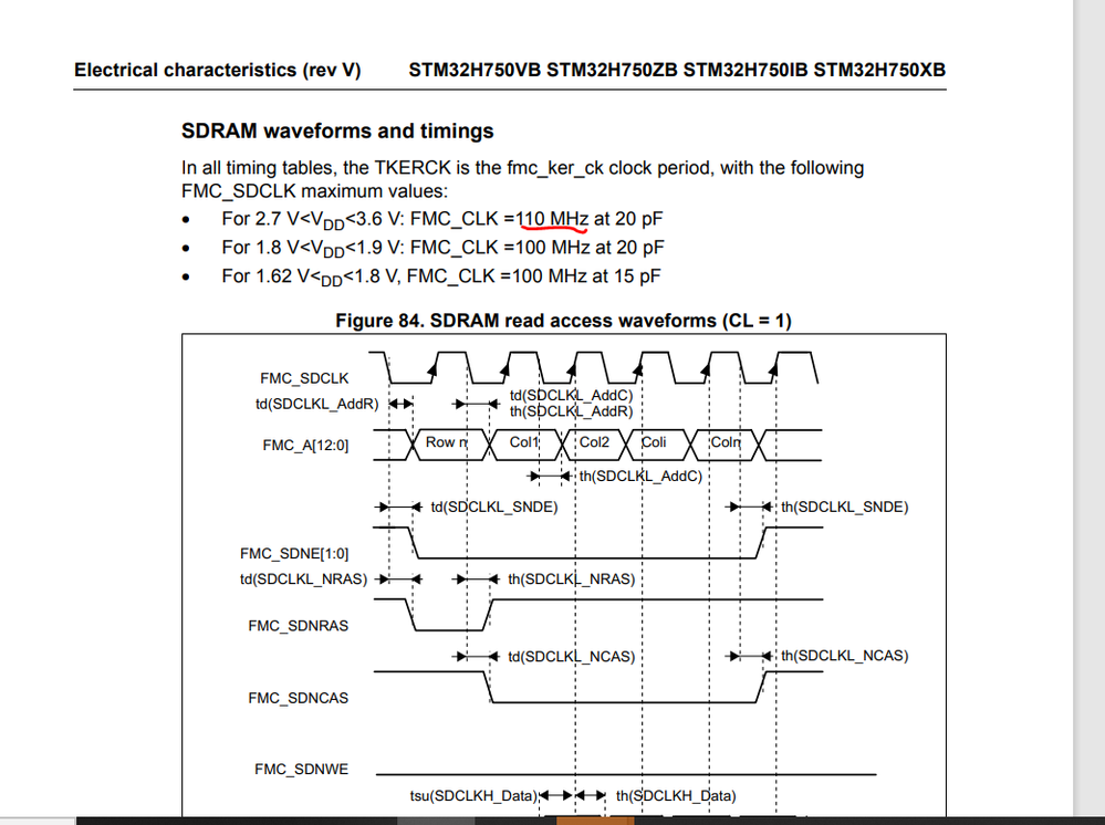

STM32H750IBK6 REV V sample what is max FMC CLK we can run SDRAM
the datasheet says 2 different values for rev V and REV Y IC revision what is safe area of operating FMC CLK with SDRAM

Thanks ,i am from hw side i am still understanding datasheet
but with rev V sample when we run 90MHZ or 99 MHZ it will work but above 100MHZ , SDRAM have 1 bit error in data but datasheet says we can run @110MHZ
Not sure it does, it implies that they tested / characterized it on their implementation, not yours. As frequency increases signal integrity issues will be a big issue, and what loads are being driven/over-come. You might want to engage with an FAE, and find out what platform they validated the 110 MHz operation on.
That it's not 120 MHz suggests there's either a critical path, or the IO cell has a drive / energy issue, as there's plenty of SDRAM on the market capable of 133 or 166 MHz operation, I'm prone to think it's an internal or interface limitation.
That yours hits the ceiling at ~100 MHz suggests there's perhaps a board level integrity issue, or that you need to adjust or back-off the slew rate, or check the IO Cell Compensation

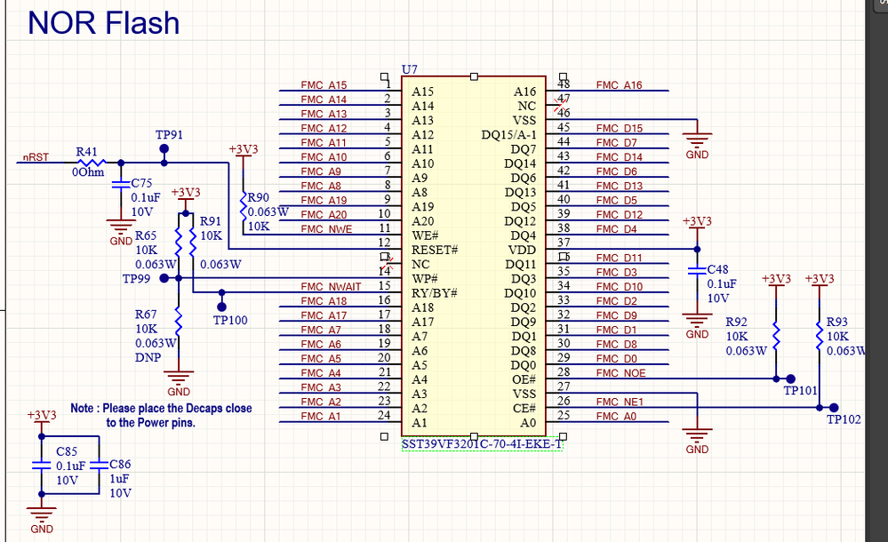

2023-03-09 11:11 PM
do you think NOR flash load capacitance of 10 pf also limiting frequency for SDRAM to run at limit
