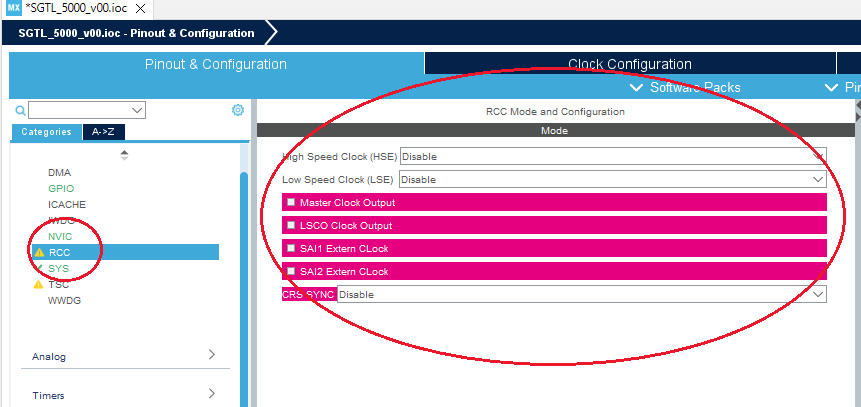

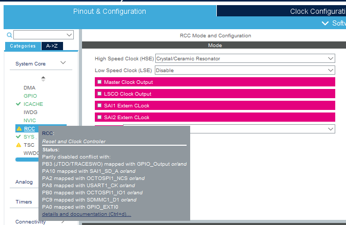

I connect my I2C but when I connect an oscilloscope I have nothing on the clock signal. So probably I misconfigured my clock. Could you give me the information? Thanks in advance.
In this picture below I've a warning, do you know how to remove this warning please ?
Thank you for your helps.

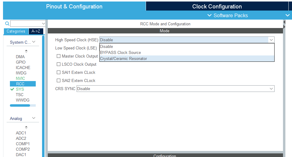

For the clock configuration, you can manager your clock with the tab "Clock Configuration"
You have to choose your Source:
If you select the MCU selector, you will have all peripherals without default mode.
Hope my answer helped you!

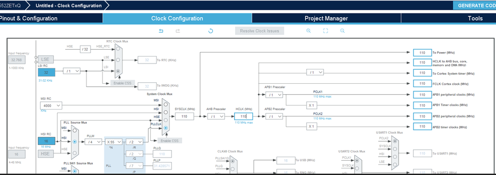

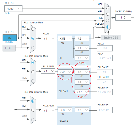

2023-03-06 4:24 AM
Thank you for your helps, I have STM32L552E-EV evaluation Board and in your first screenshot I can't see the bottom of the screenshot, could you send me a complete copy of the screenshot please ? Why in the left of your picture all is green and for me I have the yellow color with exclamation marks, I'm afraid something is wrong that why I don't have the Clock of I2C. Normally it's automatic.

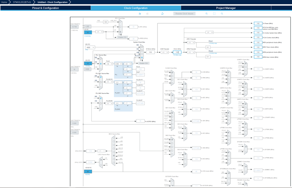

2023-03-06 5:05 AM
Please find the screenshot in the attached file.
Foued
2023-03-06 6:54 AM
Thank you but I can see only the picture above but I can't see the one below
Can you please show me of the rest of the picture.
Thank you

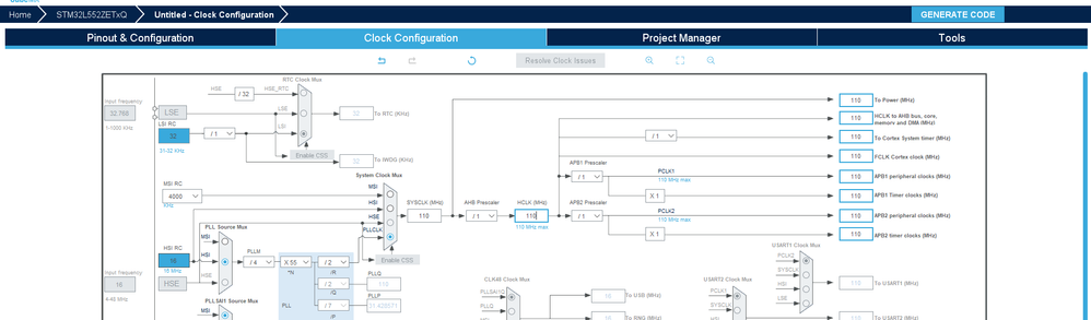

2023-03-06 6:59 AM
Foued
2023-03-06 7:02 AM
Thank you, I'll do the same configuration with my evaluation board and I hope I don't have any warning again.

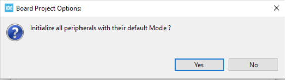

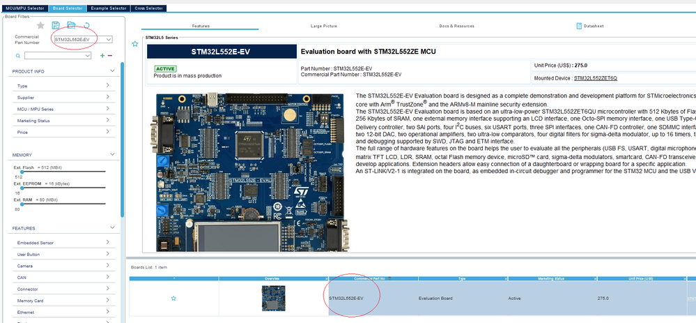

2023-03-06 7:10 AM

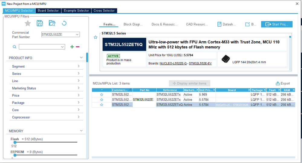

Now with STM32cube i selected my evaluation board like this picture
I don't slected by default, because my configuration is probably not the same as default.
I don't have the possibilty to do the same as your configuration.
Do you also have the STM32L5 card? Or else it's not very important. And When I want to generate the code it shows me errors.
Do you know where this error comes from ?

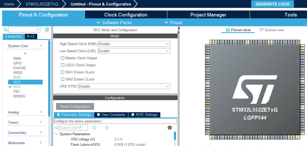

2023-03-06 7:28 AM
I have always the warning about RCC.
Something is wrong ?
2023-03-06 7:34 AM
I f you try with MCU selector and select the STM32L552ZE MCU:
Foued
