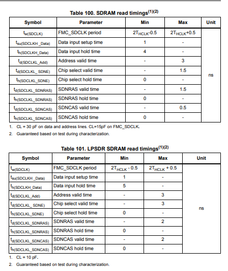

For SDRAM read timing, I recommend you referring to DS10693 Rev 10 Table 100. SDRAM read timings and Table 101. LPSDR SDRAM read timings.
