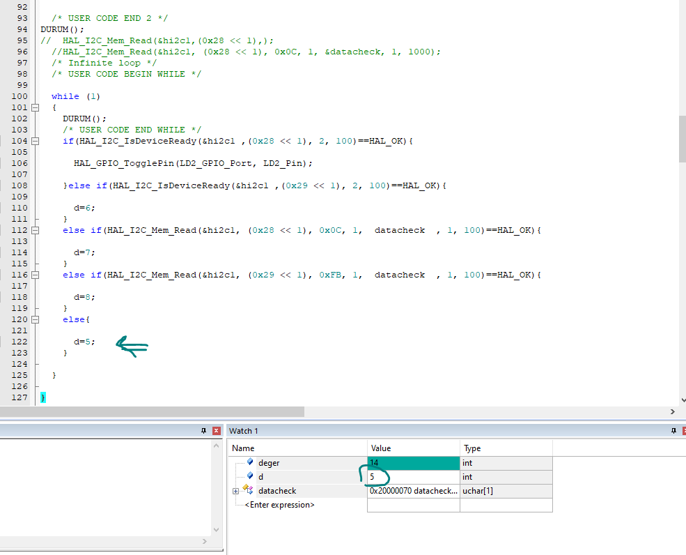

I wanted to see if the bno055 sensor is ready and set the PB8, PB9 pins as SDA, SCL. (my mcu = stm32f334r8)
connections
SDA_pin -> SDA pin sensor
SCL_pin -> SCL pin sensor
VCC -> VCC
GND -> GND
but the variable is never HAL_OK
thanks for answer.

@KHALSI_Foued I checked the maximum speed and default value but same result

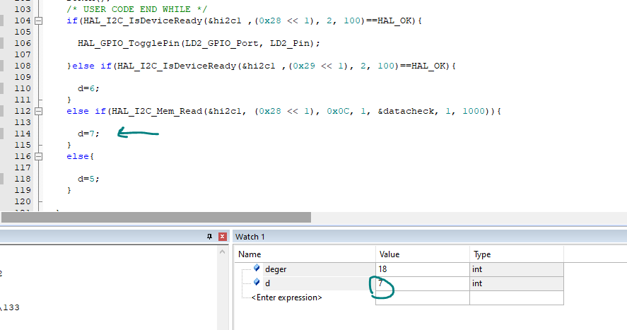

Because It's works (0x28<<1) with
HAL_I2C_Mem_Read()Foued
2023-03-03 10:10 AM

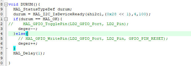

actually it works this way but why didnt work HAL_I2C_IsDeviceReady function
2023-03-03 2:00 PM
sorry my fault same result ( I checked pin connection etc.)
2023-03-05 8:26 AM
Is ADR pin important for device address?

Please try (It works fine ) :
// Check if BNO055 is ready
uint8_t ready = 0;
while (!ready) {
if (HAL_I2C_IsDeviceReady(&hi2c1, 0x28 << 1, 10, 1000) == HAL_OK) {
// BNO055 is ready, perform additional initialization
ready = 1;
} else {
// BNO055 is not ready yet, wait and try again
HAL_Delay(100);
}In this example, the code checks if the BNO055 device is ready by performing an I2C read operation on the BNO055 address (0x28 << 1) with a timeout of 10 milliseconds and a maximum delay of 1 second. If the read operation is successful, the HAL_I2C_IsDeviceReady function will return HAL_OK, indicating that the device is ready.
the read operation fails or times out, the code will wait for 100 milliseconds and try again.
Foued
2023-03-09 10:50 PM

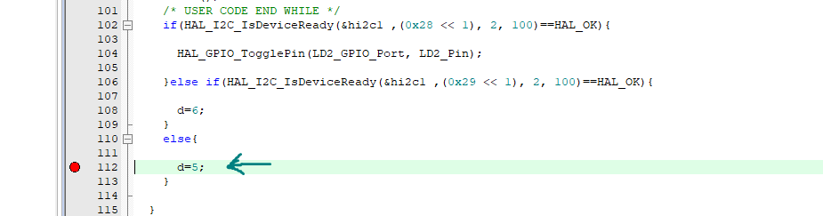

I checked sca scl pin and work. But same error with ur code
