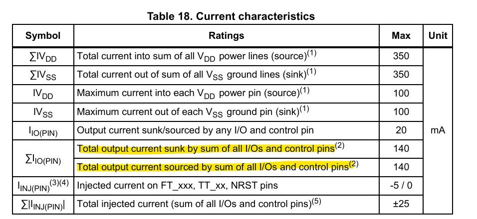

2026-01-08 6:36 AM
Dear mƎALLEm,
Thanks for sharing your inputs — I understand your point.
Based on the datasheet table I have attached, the maximum I/O current that the VDDIO pins can handle appears to be 140 mA.
Could you please confirm if my interpretation is correct?
Thank You.

2026-01-08 7:05 AM - edited 2026-01-08 7:20 AM
That's the maximum current sunk and sourced by the sum of all IOs and not the power consumption of your application.
If you need to ask what is the maximum current sink/sunk on VDDIO ring, I can ask that question to the internal teams but again this is not the power consumption. The power consumption on VDDIO depends on your specific application.
