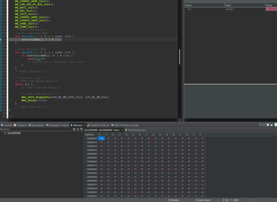

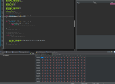

2025-02-04 11:32 PM
/* USER CODE BEGIN PV */
volatile uint8_t *externalRAM = (uint8_t*) 0xC0000000;
const uint32_t size = 8 * 1024 * 1024; //8MB
/* USER CODE END PV */
/* USER CODE BEGIN 2 */
//write external RAM
for (uint32_t i = 0; i < size; i++) {
externalRAM[i] = i % 256;
//read external RAM
if (externalRAM[i] != i % 256) {
asm("nop");
// insert error handling logic here
/* USER CODE END 2 */

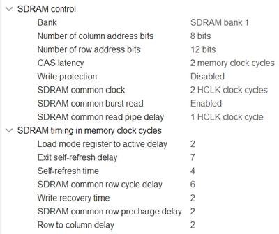

/* USER CODE BEGIN FMC_Init 2 */
FMC_SDRAM_CommandTypeDef Command;
/* Step 1 and Step 2 already done in HAL_SDRAM_Init() */
/* Step 3: Configure a clock configuration enable command */
Command.CommandMode = FMC_SDRAM_CMD_CLK_ENABLE; /* Set MODE bits to "001" */
Command.CommandTarget = FMC_SDRAM_CMD_TARGET_BANK2; /* configure the Target Bank bits */
Command.AutoRefreshNumber = 1;
Command.ModeRegisterDefinition = 0;
HAL_SDRAM_SendCommand(&hsdram2, &Command, 0xfff);
HAL_Delay(1); /* Step 4: Insert 100 us minimum delay - Min HAL Delay is 1ms */
/* Step 5: Configure a PALL (precharge all) command */
Command.CommandMode = FMC_SDRAM_CMD_PALL; /* Set MODE bits to "010" */
/* Step 6: Configure an Auto Refresh command */
Command.CommandMode = FMC_SDRAM_CMD_AUTOREFRESH_MODE; /* Set MODE bits to "011" */
Command.AutoRefreshNumber = 2;
/* Step 7: Program the external memory mode register */
Command.CommandMode = FMC_SDRAM_CMD_LOAD_MODE;/*set the MODE bits to "100" */
Command.ModeRegisterDefinition = (uint32_t) 0 | 0 << 3 | 2 << 4 | 0 << 7
| 1 << 9;
/* Step 8: Set the refresh rate counter - refer to section SDRAM refresh timer register in RM0455 */
/* Set the device refresh rate
* COUNT = [(SDRAM self refresh time / number of row) x SDRAM CLK] – 20
= [(64ms/4096) * 100MHz] - 20 = 1562.5 - 20 ~ 1542 */

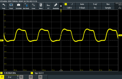

HAL_SDRAM_ProgramRefreshRate(&hsdram2, 1292); // 84MHZ
/* USER CODE END FMC_Init 2 */
