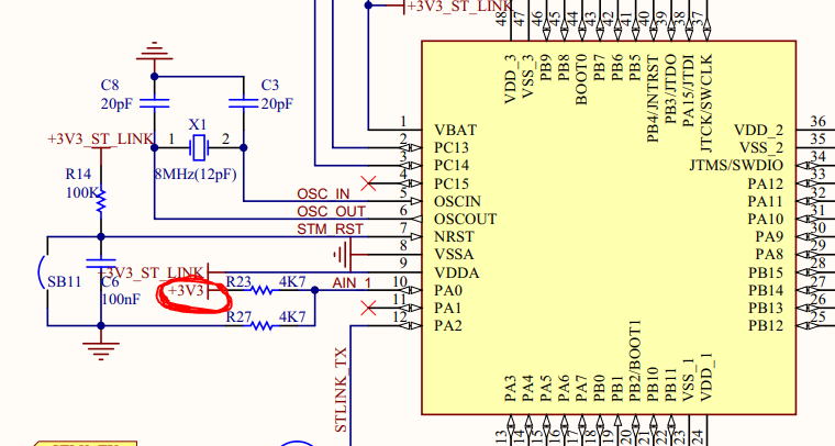

The only current path going from 3V3 and not passing though JP6 i can find is one:
I measure 1.9 V at R23. It gives a current of 400uA. Since i don't need STLink, maybe i could remove R23 and thus delete those 400uA?
