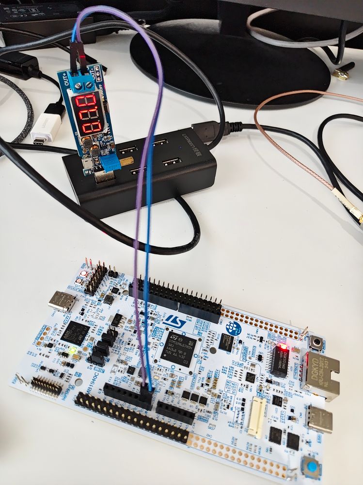

When I supplied 7V through VIN, the current consumption was only about **4 mA**, and the board LEDs looked like in the attached photo. However, the B-CAMS-IMX camera video output, which had previously appeared on my laptop, no longer appeared.

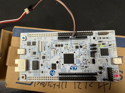

Hi Hong, I am validation engineer of this N6 nucleo board, I have tried to supply 7V to VIN again, and did not find any issue, the board can work well on both supply 7V on VIN and then supply by STLink USB, the 5V and 3V3 voltage also are OK. my board version is MB1940-N657X0Q-C02.
1. Are you sure your VIN input is brown wire-7V and black wire-GND?
2. use STlink programmer to connect the board, must be in **DEV BOOT mode**.
