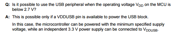

Thank you for designing with STM32L4 MCU. If you want to use USB, then you need to keep VDDUSB on at least 2.7V, while rest of VDD pins can be supplied with lower voltage, for example 1.8V, which you mentioned.
Statement, which confirms this can be found is ST documentation: application not
. Please see the extract below:Regards

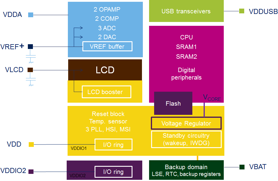

Start from looking at the STM32L4 family. It has separated USB, VDDIO1 and VDDIO2 supplies which would enable a rich mix of diverse supply voltages to coexist. For each group of GPIO supply voltage there are the usual serial interfaces suspects. This way, external voltage shifters might be avoided.

it seems to me that maybe STM32L4 can be an interesting solution for you. STM32L4 in packages with big amount of pins (LQFP144, BGA132, CSP72 and CSP81) have VDDIO2 domain. This domain has a dedicated supply pin, which level can be in range of 1.08 ? 3.6V, comparing to VDD 1.71 ? 3.6V and VDDUSB 3 - 3.6V. VDDIO2 domain supplies only pins from GPOIOG, while VDD supplies rest of the GPIOs. With this solution you can easily get a voltage level tranlator or pins operating on different voltage levels.
Regarding the evaluation boards with STM32L4: you can use
, as it offers STM32L496 in LQFP144 package. Unfortuantely VDDIO2 on this board is connected to VDD, so you would need to cut a wire and make hardawre modification on your own.Regards

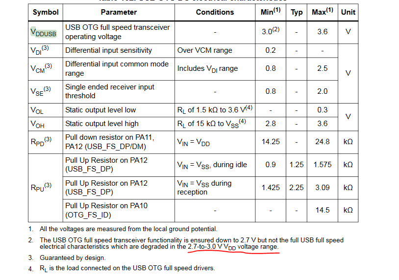

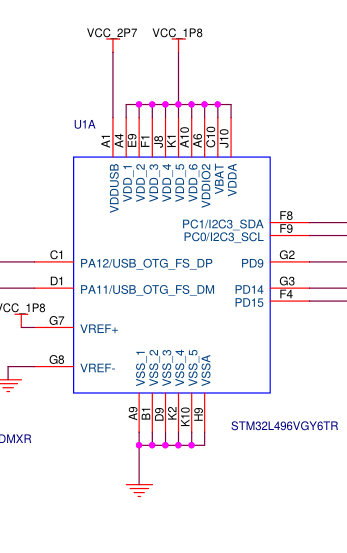

I am in similar situation With STM32L496VGY. I am trying to operate VDDUSB @ 2.7V (I can increase upto 3V). But All other VDD (Including VBAT,VDDA,VREF+) @ 1.8V. From the datasheet I found a statement saying that ''The USB OTG full speed transceiver functionality is ensured down to 2.7 V but not the full USB full speed electrical characteristics which are degraded in the 2.7-to-3.0 V VDD voltage range''. Which VDD datasheet is referring to is it VDDUSB or all other VDD(Including VBAT,VDDA,VREF+). If that the case do i need increase the VDD(Including VBAT,VDDA,VREF+) to 2.7V to make USB working.

PA11/PA12 don't meet USB electrical specs below a 3.0V supply. I'd assume the ramification there would you couldn't get USB certification, and attachment would be problematic across the installed user base. I generally prefer that the tech support staff don't want to murder me or poison my coffee.
2018-05-14 9:04 AM
Hai Clive
Its seems there is less clarification on mixing up different voltage on STM32MCU. Anyway I am willing to accept USB function with degraded performance.

Hello Jismal Jamal,
