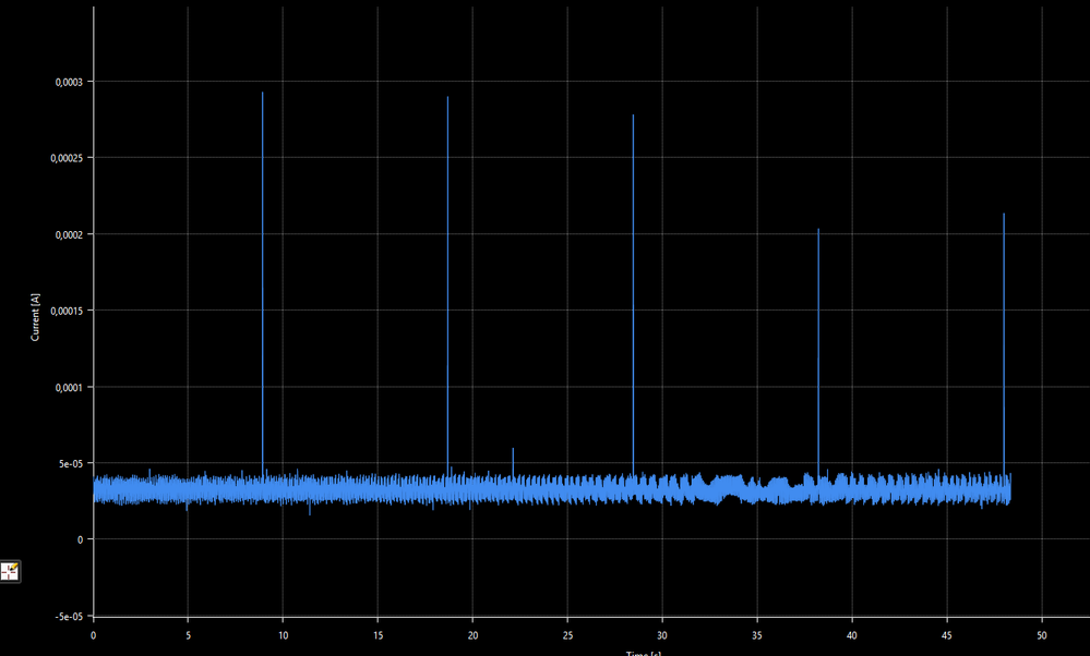

Hello, I have analyzed the PCB layout (using the CAD documentation provided by the ST), and I am measuring the current using an external power supply with measuring capabilities (SMU). I have removed the JP5 and JP4 of NUCELO-U545RE-Q and I am supplying through JP5 pin 1. According to the layout on Altium, this pin will only supply the MCU, so I think that part should be ok. I have added prints for debugging and the system seems to only be entering and exiting the low power states every 10 seconds (driven by RTC). I have also added this line after peripheral init to disable the debugger
HAL_DBGMCU_DisableDBGStopMode();I can leave a print of my current measurement, but according to datasheet STOP2 mode with RTC at 3.3V should be around 3.5uA.
BR
