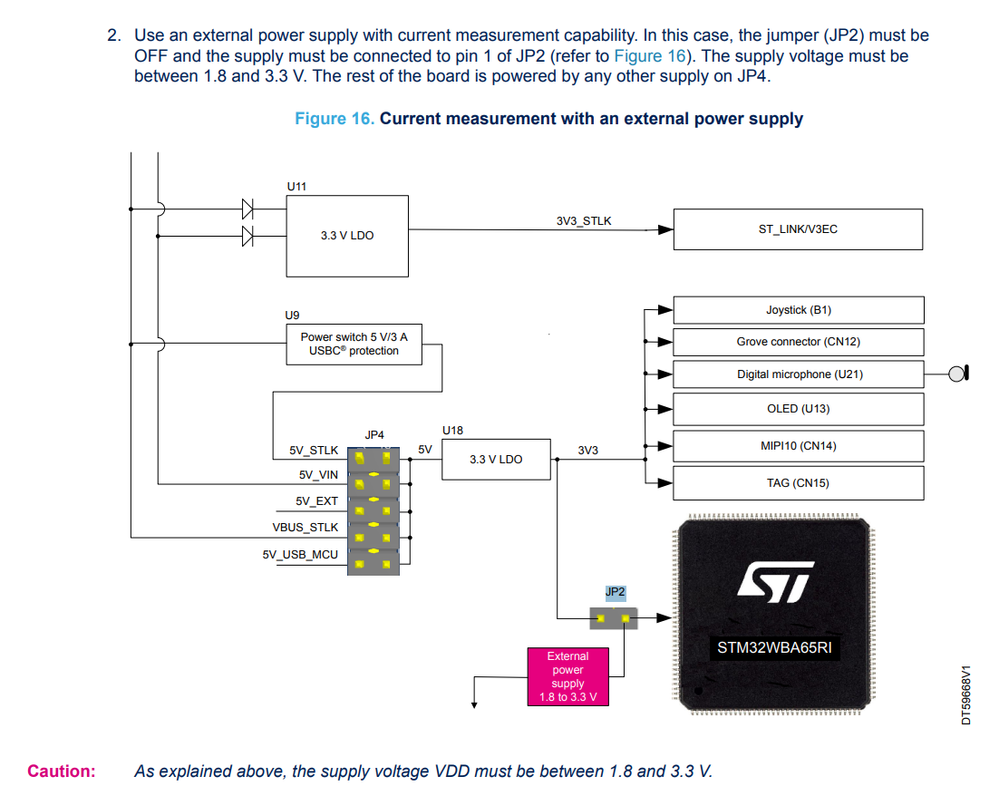

2026-04-08 8:15 AM
I am using the STM32WBA65RI Dev Kit. For current measurements, I am powering the board with an external supply that includes current measurement capability, connected directly to pin 1 of JP2. The JP4 jumper is removed.

2026-04-08 8:31 AM
I am using the NUCLEO-WBA65RI. According this this image, I am powering the MCU directly so the ST-Link below should be totally disconnected (I assume)
Also, do you have any insights on how to integrate BLE advertise with this standby mode?
2026-04-08 9:04 AM - edited 2026-04-09 4:05 AM
@JPortilha wrote:According this this image, I am powering the MCU directly so the ST-Link below should be totally disconnected (I assume)
I think not: The ST-Link is still connected - just not powered.
Again, check the schematics to be sure.

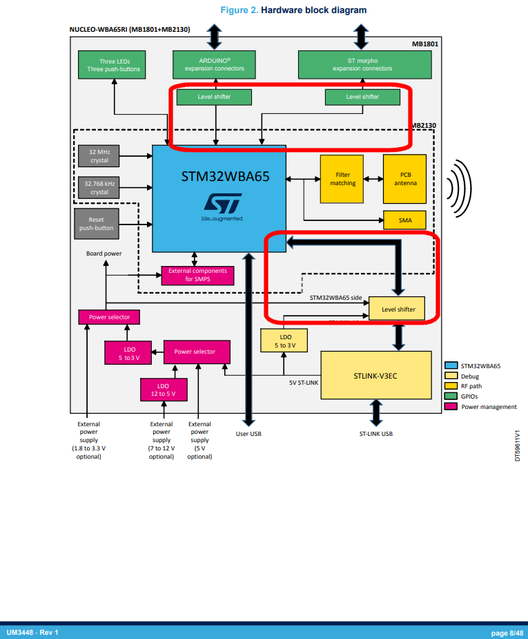

2026-04-09 4:13 AM
What about all these connections (from the User Manual):
Again, it's only tiny amounts of current you're talking about!
Maybe try removing the MCU RF board (MB2130) from the mezzanine board (MB1801) ?

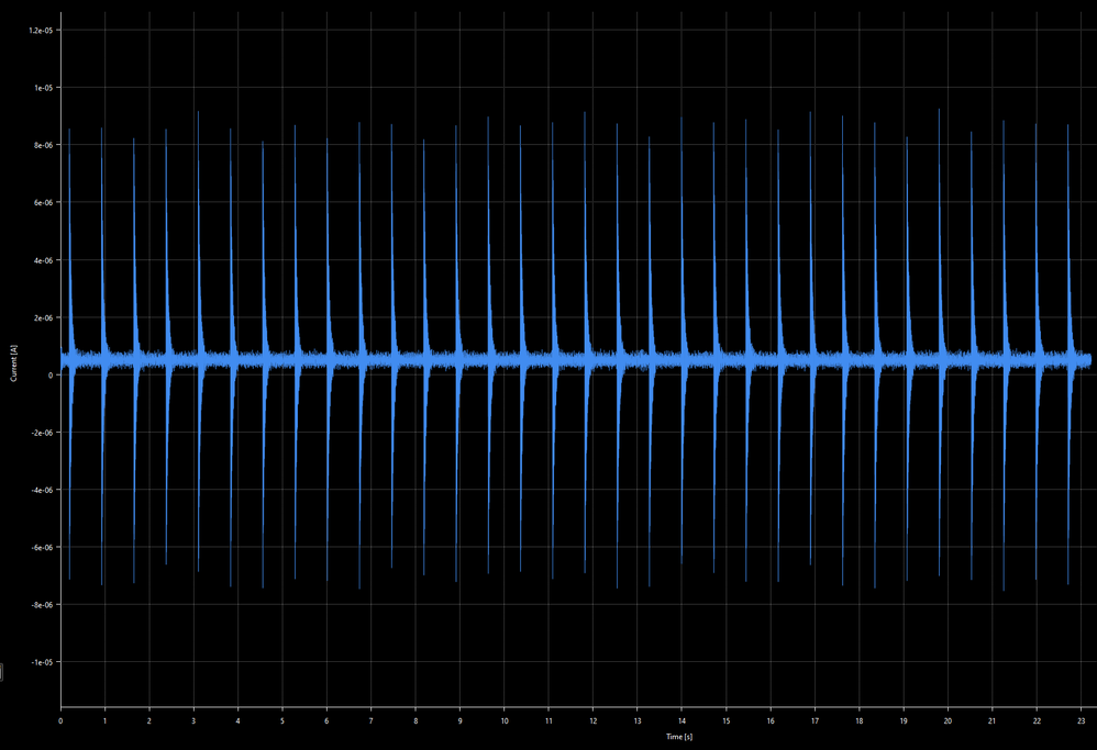

2026-04-09 8:35 AM
Hello, I have removed the MCU board (MB2130), and I am powering up via CN4 pins. I have shunted the necessary solder bridges underneath the board I got these results while in stanby mode.
I can´t figure out what are those negatives spikes. The average value should be around the nano amps scale, but again not the 330nA at 1.8V specified in the datasheet.
BR
2026-04-09 8:52 AM
I don't know.
What are you measuring with?
A schematic and some good, clear photos would help to fully describe the setup.
Is the chip waking up periodically - something just under 1s ?
What is the average current between the spikes?
Remember that the datasheet figure is purely internal to the chip, so you will never achieve that in practice: there will always be some leakage due to external components - capacitors, etc...
