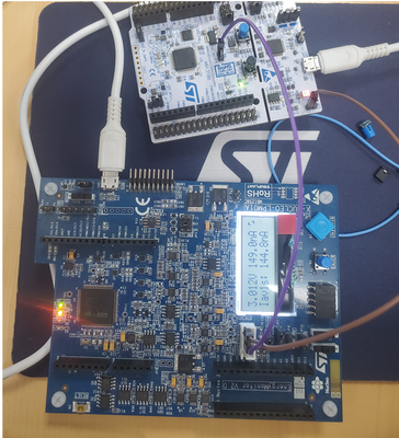

I am currently working with the NUCLEO-L452RE-P board and trying to evaluate its low-power performance.
I am measuring the current consumption using jumper JP6 (IDD measurement point). The jumper is removed and a multimeter is connected in series.
My setup:
Board powered via ST-LINK USB (then power-cycled before measurement)
No external peripherals connected
All GPIOs configured as analog, no pull-up/pull-down

Expected behavior:
According to the datasheet, the STM32L452RE should consume in the range of ~67nA in Shutdown mode
Observed behavior:
I consistently measure around 20–30 µA on JP6 in Shutdown mode. The value is not perfectly stable and fluctuates.
Questions:
Is this expected behavior when using the NUCLEO-L452RE board?
Could the measured current be dominated by on-board components (e.g. level shifters, ST-LINK interface, SMPS, etc.) even when measuring at JP6?
What additional steps are required to measure the true MCU-only Shutdown current on this board?
I want to keep using the NUCLEO board if possible, but need to reduce the current significantly for a low power application
Any guidance or experience with accurate low-power measurements on this board would be greatly appreciated.
Thank you!
P.S.
I have also attached my .ioc file and a photo of my measurement setup
Edit: I observe approximately the same current consumption when using Stop2 mode which is very strange to me...

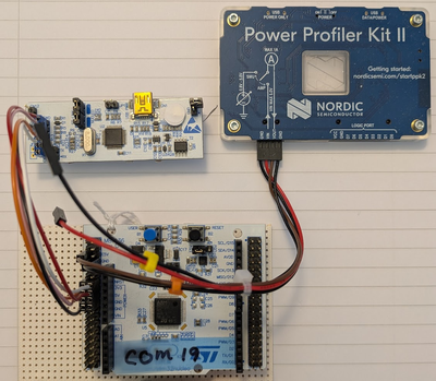

@Mike_ST wrote:>> Could the measured current be dominated by on-board components (e.g. level shifters, ST-LINK interface, SMPS, etc.) even when measuring at JP6?
Yes it can,
Absolutely!
@HelloWorld4 you need to check the schematics very carefully for all possible leakage paths.
I suggest that you break-off the ST-Link section of the board to be absolutely sure that there's no leakage to the ST-Link.
For example:
(as shown, the ST-Link part is connected via wires for programming - disconnect for current measurements!)
