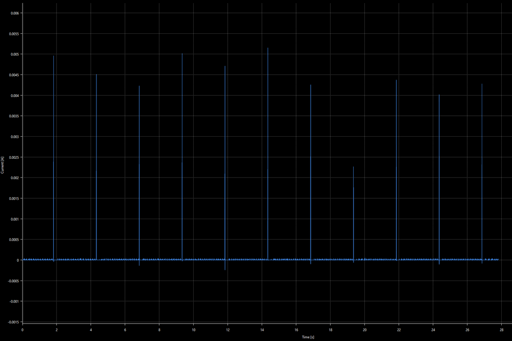

When the system enters standby, the current consumption is very small until the next radio event, as shown in this image of the current measurement that I have take.
With these examples (bare-metal, without an RTOS), I can measure current consumption in the microamp range, which is acceptable. However, for my application, I would like to further reduce consumption into the nanoamp range.
