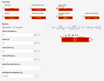

First check, what track width and distance gives good result on 2 layer, then on 4 .
try also:
https://www.digikey.de/en/resources/conversion-calculators/conversion-calculator-pcb-trace-impedance
2025-01-20 7:07 AM
Thank you. So I calculated using the website you suggested, and got 140.4440... This means that I need to probably redesign my board, right?
I figured out that by decreasing the height, we can decrease impedance dramatically, but I also found that 0.8mm is not enough to be in a range of 70-110 orm, because the trace width should be smaller than the USB typeC receptacle pins. Since, on JLCPCB, it apparently cost more if you choose less than 0.8mm... I think I will try designing 4 layer board this time.
