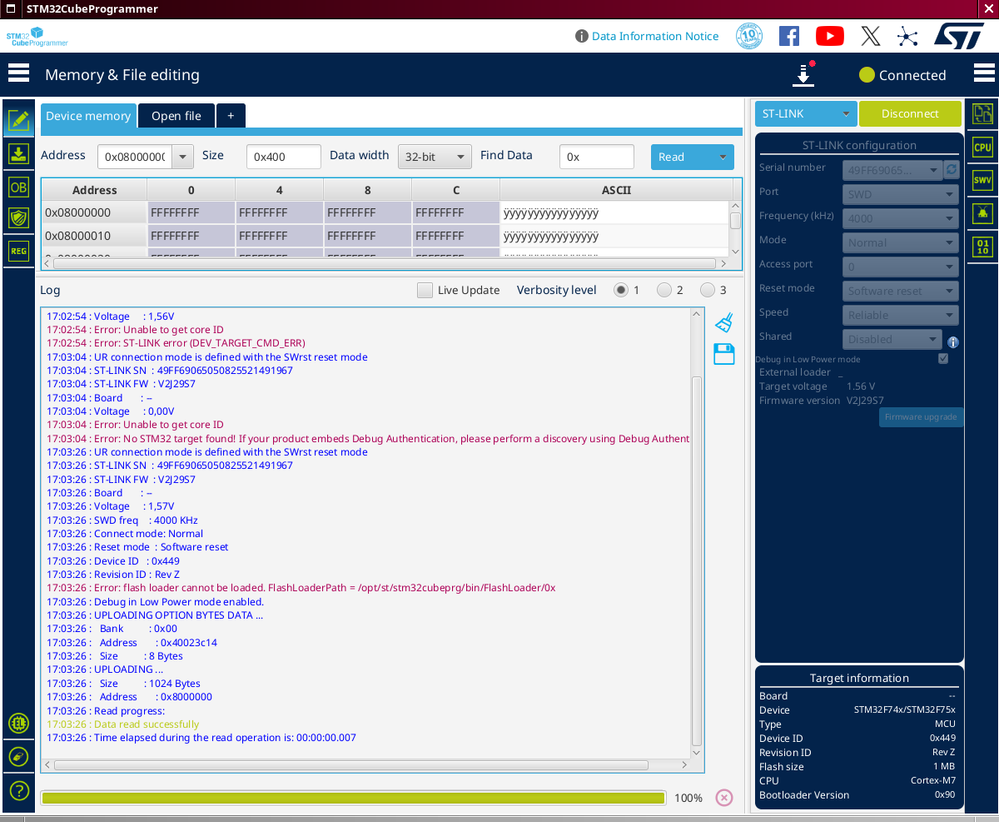

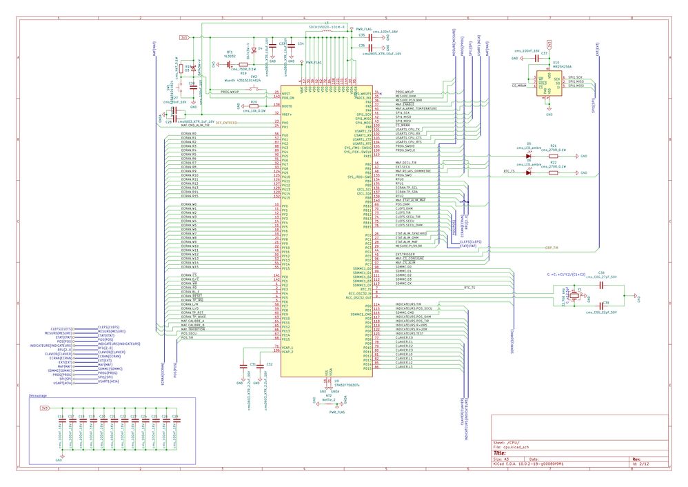

I have made a custom PCB with a STM32F756 and I'm trying to program this MPU through STlink. My main workstation runs Linux and I use stlink tools.
To flash this MPU, I have connected ST-Linkv2 to my PCB (NRST, SWCLK, SWDIO, SWO, GND) and I can obtain a answer from MPU:
hilbert:[~/zephyros/zephyr/samples/basic/blinky/src] > st-info --probe
Found 1 stlink programmers
  version:    V2J29S7
  serial:     49FF69065050825521491967
  flash:      1048576 (pagesize: 2048)
  sram:       327680
  chipid:     0x449
  dev-type:   STM32F74x_F75x
 But I unable to flash a test program... I have tested with standard user or root.
Then you need to post your schematic.
Has this PCB ever worked before?

PCB runs as expexcted. I have checked all signals and all power supplies.
On schematic, stlink is connected to PROG{PROG} (NRST is connected to WKUP). Only TVS diodes are added on PROG bus.
My StLInkv2 is an official one, not a copy.

I have exactly the same error.
I receive some errors during connection but after hard reset of PCB, connection is done but why is voltage only 1.57V ? CPU is powered from 3V3 line. And I have exactly the same error "flash loader cannot be loaded".

There's something wrong with your power supply:
No, I don't think. I don't understand this message, but I have checked my 3V3 line (with scope, not with a multimeter) and checked pins 17, 30, 39, 52, 62, 72, 84, 95, 108, 121, 131, 143 and 144. All show 3.3V.
Well the ST-Link is measuring less than 1.5V - so there's something definitely wrong in the setup!
How ST-link does measure this voltage ? Is a value returned by CPU or directly measured by ST-link ? Mine is only connected to PCB with 5 lines : nRST, SWCLK, SWDIO, SWO and GND.
With scope, I see :
- nRST : 3V3;
- other signals 0 or 3V3 (with some communications) : SWCLK (3V3 when idle), SWDIO (3V3 when idle), SWO (0 when idle).
All signals are clean.
See the ST-Link User Manual - it senses the voltage on the Vtarget line.
You should have that connected to your target.
