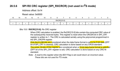

The Analog Devices ADE9430 uses a a 16-bit CRC (CRC-16-CCITT) and from what I originally read  the STM32F413ZH processor supports 32-Bit CRC (CRC-32-CCITT).  Diving deeper into the NUCLEO-144 STM32F413ZH processor manual section "29.4.2 CRC calculation" indicates "The SPI offers CRC8 or CRC16 calculation depending on the data format selected through the DFF bit." When the DFF bit (SPI_CR1 bit 11) is 0 it uses CRC8, when the DFF bit is '1' it uses CRC16.

I was thinking of setting the DFF = 1 (16-Bit transfers) so when I read a  32 bit register the SPI Bus uses two 16-bit transfers to retrieve the register contents. But I was concerned how the STM processor generates it CRC. Does it generate the CRC accumulative across all the data and CRC 16-Bit data transfers? Or does it generate it based on each 16-bit data received including the final CRC sent by the ADE9430?
After the data and CRC are transmitted by the ADE9430 the HAL_SPI_TransmitReceive() function appears to check for a CRC error using a SPI_FLAG_CRCERR (see below). I am wondering how the SPI_FLAG_CRCERR  is actually detected. it seems like it needs to accumulate the data across the entire SPI transmission and it should end up exclusive OR-ing it self to all zeros if the CRC is good... Otherwise its a CRC failure.

Yes, the STM32F413 can talk to the ADE9430 over SPI, but the STM32 SPI hardware CRC feature is probably not a direct match for the ADE9430 protocol. On this STM32, DFF=0 means 8-bit data frames and only an 8-bit SPI CRC, while DFF=1 means 16-bit data frames and a 16-bit SPI CRC; since the ADE9430 uses 8-bit data bytes followed by a 16-bit CRC over the whole transaction, the safest approach is usually to leave SPI in 8-bit mode and calculate the ADE9430 CRC-16-CCITT in software over the received data bytes.
