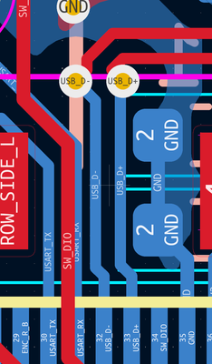

This is my PCB design for a USB data line... I hope this routing is ok...
2025-01-16 7:31 AM
Routing looks ok...so far, i can see it; just at U5 : is the line D+/- here connected inside this chip ? did you check continuity ?

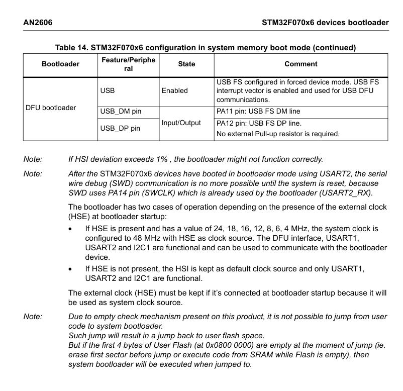

According to the datasheet from ST, USBLC6-2SC6 (the U5 chip) is internally connected (at least that is what I thought).
I am unsure what I should do for the datasheet for the device bootloader. Should I erase my code before trying DFU mode?

You don't need to erase, if bootloader running, you can flash, erase etc.
Just on your layout, D- close to CPU has a via, but there is also another connection to red track and to a pin. What is this?
Can you look with a scope to the signal at the CPU pins, to prove the signal looks ok?
2025-01-16 4:50 PM
Sorry for the late reply!

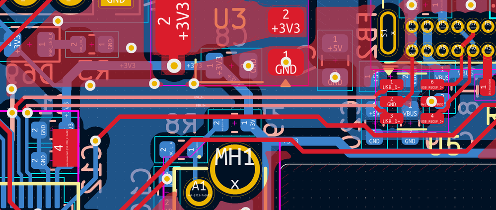

Here is the close-up.
the orange line on the USBD- via is just a silksceen.

I used KiCad's differential routing tool, assuming those traces are almost the same length and maintaining close distance, and I also tried to minimize sharp corners and vias.
I also tried not to allow any other traces to cross the USB data line, and when I needed to do so, I made sure that it crossed perpendicular to the USB data line.
But, I am not sure about the 90ohm impedance rule; I knew that it existed, but I am not sure how to actually achieve that.
What should I do?
2025-01-18 3:30 AM - edited 2025-01-18 3:37 AM
Afaik in kicad main menu is tools/... , pcb tools or so, there is a impedance calculator
(track width x distance to ground plane in pcb material -> approx. impedance )
+ no need to match this +/- 1 ohm ; just it should be in range 70...110 ohms (center of range is 90 ohms).
Because it should match the cable , as good as possible, so it should be :
The USB 2.0 specification stipulates an impedance between 76.5 and 103.5 Ω for the cable when measured during differential transmission.
2025-01-20 2:08 AM
I searched a little about this and tried to calculate using the KiCad calculator tool. Then I got Zeven: 189.26 and Zodd: 67.822.
This is mostly because I designed the board with only 2 layers, meaning that the distance between the ground plane and D+- was about 1.6mm (the board thickness)...
I assume those numbers aren't great, should I redesign it with 4 layers?
