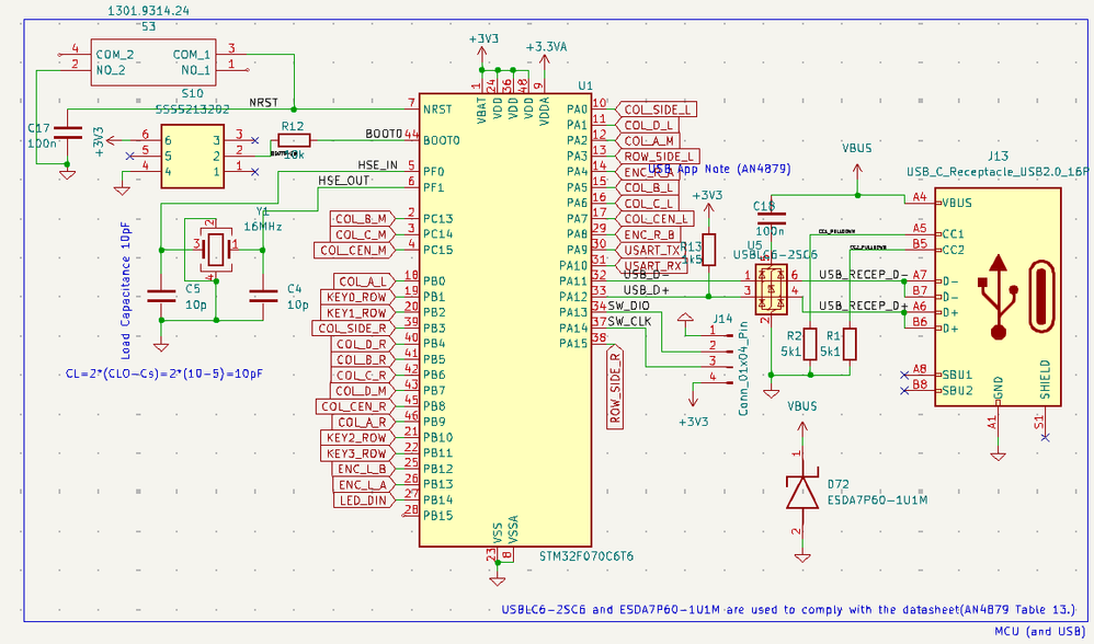

I am trying to create a custom keyboard, and I was trying to flash my board with stm32f070c6t6 MCU in DFU mode using cube programmer, but I keep getting "no DFU detected" (of course while pulling BOOT0 pin high).
Also, every time I plug my device into my PC, the error message says, "Windows has stopped this device because it has reported problems (Code43). A request for the USB device descriptor failed."
I am new to this field, so I am running out of ideas.
I put 16MHz crystal and set up 48MHz for USB, I configured the device description based on this website; https://controllerstech.com/how-to-use-stm32-as-a-keyboard/
I pulled up D+ with a 1k5 resistor, I pulled down both CC1 and CC2 with 5k1 resistors.
I checked the voltage on the regulator and found it was totally fine (both 3v3 and 5v). I also checked the soldering and made sure that no pins were bridging.
I managed to flash the chip using STlink recently, but since this board is designed to be a keyboard, I expect the USB to work fine.
I am feeling so stuck, I have already spent like a total of 10 hours trying to figure it out, so it will be really helpful if someone tells me where I made a mistake.

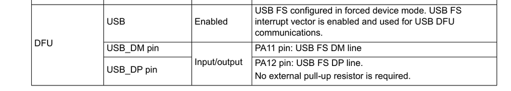

From AN2606 , for F070x6 :
..so no 1k5 needed ! (remove it.)

So, I tried to test with the resistor removed, but it did not work...
Still, even though the boot0 pin is pulled high, the cube programmer says "no DFU target", and when I plug in my device to the PC, I get "USB device not recognized".
What should I do?

Exchange Dp vs Dn .... maybe you puzzled. (Everybody tries this some time... :) )
Or to long / not screened lines...its a 12Mbit connection, so every "free" wire over 3cm or so ...might kill connection.
2025-01-16 1:59 AM - edited 2025-01-16 2:06 AM
Yeah… I do have long wire, like about 4cm long one…
so I guess that’s the reason why it won’t work…
thank you!
2025-01-16 2:58 AM
...and double check DP - DN is correct , not puzzled.
And check pin speed for USB (PA 11+12) is medium or high.
And remove this C18...it might distort the signal (as long its not charged to ~ 3v3 ).

2025-01-16 5:33 AM
About
is no problem on a board, if you keep them ( D+/- ) together , keep same lenght and have a ground layer,
so you can get a controlled constant impedance. And keep some distance to any other trace, that carries hi-speed switching signals (that might disturb the data on USB lines).
The "every "free" wire over 3cm or so ...might kill connection " meant : free air wire, which gives impedance step and reflections.
So 40 mm on a board are no problem at all, according to the standard rules (s.o.).
Try with your board,
Then it should work.
