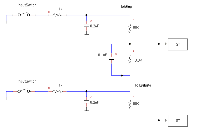

Yes there is some problem in the circuit i will try the below circuit, initially it was planned to give 12V as input now i feel it is not required.
2025-02-04 3:22 AM
I know from other STM32 parts that the internal pull-up is relatively weak, usually between 40 and 50kOhm.
In connection with your external circuitry - the 4k resistor to ground - you effectively have a pull-down configuration.
2025-02-04 3:26 AM
Yes i will remove that 4K resistor and check, should i remove the series 1k and 10K resistor as well?
