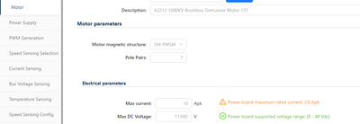

According to the A2212 Motor data sheet "Max Efficiency Current: 4 - 10A" and the maximum current is 13A.
X-NUCLEO-IHM07M1 board is limited to 2.8A (40A for B-G431B-ESC1) as mentioned at project configuration step, as then not appropriate for this motor.
I assume that you have Driver Protection error, isn't it?! Decreasing Torque Target to 0.8A, I am able to start the motor and reach 5000 RPM.

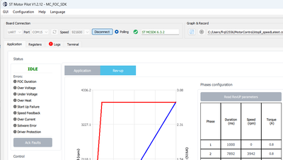

Thank you again for your helpful suggestion! I made the adjustment to the Torque Target to 0.8A as you recommended, and the motor spun up as expected, reaching around 5000 RPM. However, I realized I missed an important point in my original post.
When I attempted to use the profiler to estimate the motor parameters, I found that the A2212 motor already has parameters in the Motor SDK, which I wanted to test with both the X-NUCLEO-IHM07M1 and B-G431B-ESC1. While the B-G431B-ESC1 worked perfectly, I’m still facing issues with the X-NUCLEO-IHM07M1—specifically, the same behavior as mentioned in my original question, where the motor doesn’t spin.
Could the current limitation on the X-NUCLEO-IHM07M1 (2.8A) be causing issues with running the motor profiler, or is there another factor preventing the profiler from working as expected on this board?
Thanks again for your ongoing support!
Best regards,
Duc
2025-05-19 12:32 AM
Hello @Duc,
As specified on A2212 Motor datasheet "Max Efficiency Current: 4 - 10A". These values are achievable with B-G431B-ESC1 and not by X-NUCLEO-IHM07M1.
