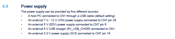

The NUCLEO-G474RE can be supplied with power by 5 different means that can be found on the user manual UM2505 :

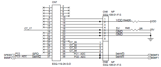

When looking at the corresponding pins from the IHM16 schematics, there is apparently no connexion that can be made without adding an external wire (from CN7_18 to CN7_6 for example) :
The layout is different for the IHM07, which explains why the power supply is directly provided.
