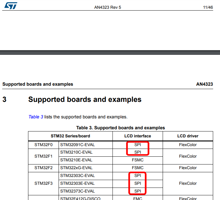

@VidulaS wrote:I am not able find any example with SPI interface and STemWin.
really?
