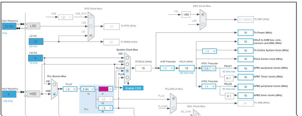

I wish to set PLL as 16MHz by HSE (STLINK 8MHz MCO).
Because HSI clock is 16MHz.

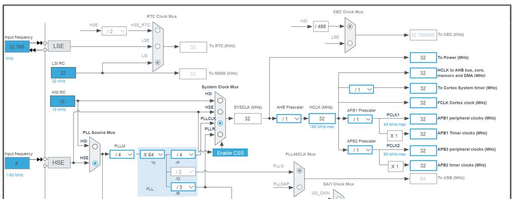

I had set PLL M/N/P = 4/64/8.
CubeMX reported P was fail . ]
So I had set P=4. and It makes PLL-CLK = 32MHz

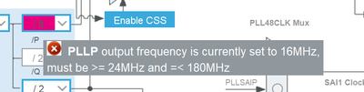

Hover over the red area to find an explanation of the issue. In this case:
Unclear why it wants that. Seems like a bug but I could be missing something.

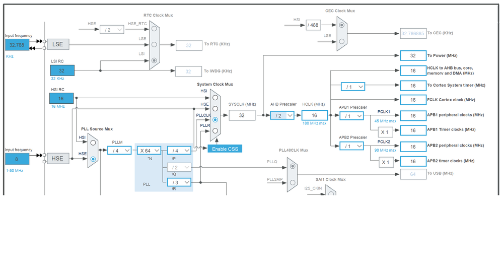

I cannot see PLL clock minimum frequency spec is 24MHz now,
But it may cause issue of this setting.
My purpose is setting 16MHz clock for application as HSI clock.
I have settled following setup as create 32MHz for MCO and divide to following path.
