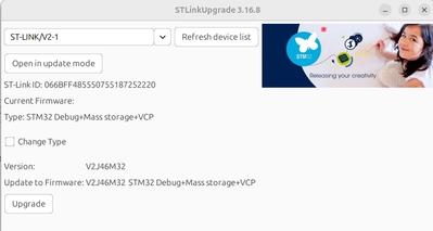

I was able to connect to my board using STM32CubeProgrammer on my Ubuntu 24.04.2 LTS laptop and upgrade it with the STLinkUpgrade program below.

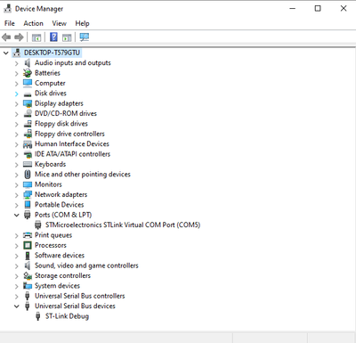

Then I connected my nucleo board to my Windows VM from Virtual Box since STLinkFlash.exe can only be run in Windows. I have installed the right STLink and JLink drivers from SEGGER website and confirmed in my Device Manager that the STLink was detected.

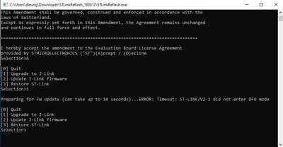

However, when I launched STLinkFlash.exe to upgrade my STLink to JLink, I got the error "ERROR: Timeout: ST-LINK/V2-1 did not enter DFU mode". I tried putting the nucleo board in DFU mode by shorting the BOOT0 pin to VDD or removing/connecting different jumpers available on the board, but none worked...

Thanks for letting me know! What is your STLink version on your Nucleo-F446RE board? When you say you know of the Windows version of this conversion tool, do you mean STLinkFlash.exe? Because that is what I used to try configuring the STLink on my Nucleo-F446RE board to JLink in my Windows virtual machine on my Ubuntu laptop. I did install the STLink USB Windows driver (STSW-LINK009 from ST) that recognized my Nucleo-F446RE board as a STLink in my Device Manager in my Windows VM, but STLinkFlash.exe failed to upgrade it to JLink with that DFU error...
