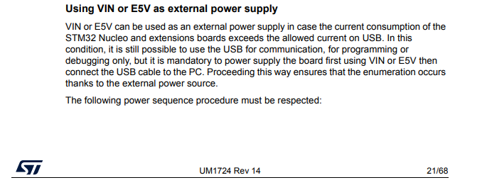

with setting of jumper JP5, you are allowed to select power supply either from USB connector CN1 or from VIN (pin8) of Arduino connector CN6.
so you just need to set JP5 to 2-3, and connect external DC power to VIN pin (7-12V) to power your board.

Also check the schematics...
