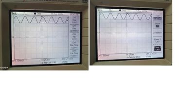

Kindly go through the attached schematic capture of developed board waveform capture at PH0-OSC_IN pin.
Getting same waveform as per Evaluation Kit (Find Attached EVM waveform)
Hope waveform we observed will specify the MCU clock requirement in terms of rise time, fall time, VIH & VIL level.
want to make sure that there is no issue in MCU Clock using external 48 Mhz crystal implementation.
in 25 Mhz & 48 Mhz crystal maximum amplitude is going at 1.8V and MCU operating at 3.3V level.
Hoping that the clock at OSC_PIN is satisfying MCU operating level.

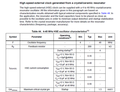

As per attached snap STM32 Datasheet suggesting to use Oscillator.
As per above table there is no specific requirement related to Vil, Vih level of crystal / oscillator output clock.
Can we go ahead with 48 Mhz Crystal with previous shared waveform results?

For clock verification of crystal do we need to follow this snap?
as per above snap there is no data available for VIH & VIL, do we need to consider VIH and VIL level for STM32?
do we consider attached EVM clock capture for our board as reference?

VIH and VIL are not relevant for crystal waveform/selection.
