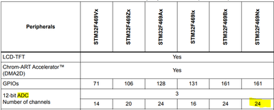

the STM32F469I-DISCO is based on the STM32F469NIH6 MCU wish (according to the DS11189) give you the opportunity to use 24 ADC channel on the same time:
If you are looking for more ADC channels, you can even look for another MCU that support more channels (ST-MCU-FINDER-PC may help you). Or you can use an external ADC to SPI converter that add some ADC channels throw SPI interface.

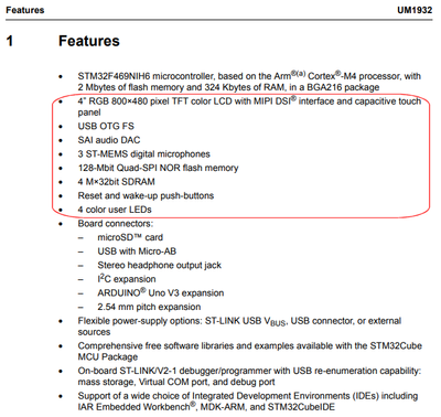

@Danodino wrote:The reference manual of the STM32F469I-DISCO states that its ADC has up to 16 channels to measure analog signals.
You mean the User Manual, UM1932?
I don't see "16 channels" mentioned in there?
@Danodino wrote:However, upon reviewing the schematic of the board, I realized that there aren't enough physical connectors for the ADC channels
That's the trouble with a development board like that - which has a loads of accessories bolted on:
All of those things use up processor pins - meaning they're not free for you to use for other things.
If you want maximum unobstructed access to as many of the chip's pins as possible, you want a dev board with as few "extras" as possible.
So you'd be better looking at a Nucleo board - they are pretty minimalistic in terms of the "extras":

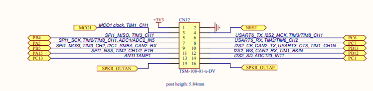

STM32F469I-DISCO has some ADC inputs on connectors, you can use:
So you have : 6 x adc in on CN8 , some (4x) on CN5+7 : PA1/2/6/7 , (2x) on CN12 : PA5 , PC1 ; 12x i found.
maybe more, just look in ds pinouts for all pins on the headers.
How many you need ? + you have all the opamps+circuit to bring clean 0...3v3 signals to the inputs ?

I found the ones you mentioned on CN8 and CN12, but I don't know how you identified the 4x from CN5 and CN7; there is no label related to ADC channels (it would be awesome if there are actually 12 available channels). Could you explain how you figured them out?

In circuit diagram you see, what pins you could use to connect ,

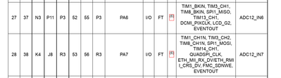

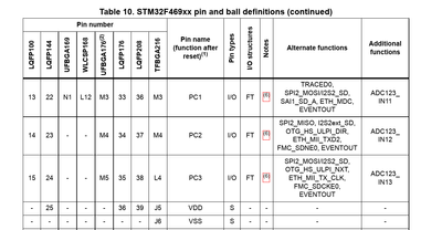

and in ds look in pin definitions, whats on these pins: looking for ADC inputs you see, they are on some group of pins:
So PA1/2/6/7 can be switched to adc inputs ...
