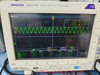

Kindly go through the attached schematic capture of developed board waveform capture at PH0-OSC_IN pin.
Getting same waveform as per Evaluation Kit (Find Attached EVM waveform)
Hope waveform we observed will specify the MCU clock requirement in terms of rise time, fall time, VIH & VIL level.
want to make sure that there is no issue in MCU Clock using external 48 Mhz crystal implementation.
in 25 Mhz & 48 Mhz crystal maximum amplitude is going at 1.8V and MCU operating at 3.3V level.
Hoping that the clock at OSC_PIN is satisfying MCU operating level.

2024-02-08 5:12 AM
Max external crystal frequency is 48 MHz, which yours meets. You should have load capacitors loaded.
The waveform looks fine.

Hi
Find attached snap, ignore previous one..
Thanks,
2024-02-08 6:29 AM
I imagine the capacitance of your scope is distorting things as well.
> Crystal having 8 pF load capacitance, added 8 pF capacitor at both pins and getting same result as without load capacitance.
Just because it works doesn't mean it will continue to do so. Follow the recommendations to have the best chance of success. A little surprised it's working at all without any load caps.

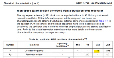

2024-02-08 7:40 PM
Hi TDK,
Referring to attached snap considering STM32 10pF load capacitance.
Thanks,
