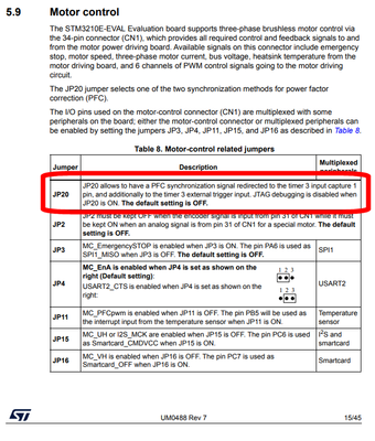

You've attached a photo of the board but I don't see the STLink connected to it. Please share a photo of the STL-ink probe that you've connected to the board. Knowing that there is no built-in STLink for this board.

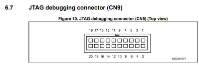

JTAG connector on which you must connect the STLink probe (CN9 connector):
Also you need to power the board with USB cable or an external power supply.
Check also the user manual of the board at this link: https://www.st.com/resource/en/user_manual/um0488-evaluation-board-with-stm32f103zx-mcu-stmicroelectronics.pdf

You realise that this board does not have an ST-Link built in?
You have to connect an ST-Link (or other debug probe) to it.
Do you have an ST-Link connected?

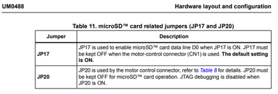

Also, check your link settings; eg,
