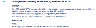

For those unfamiliar with this issue, using PC13 for anything I/O related may affect the RTC clock frequency, in case you use an external RTC crystal (LSE oscillator). This is copied from the STM32G4 errata sheet:

So when using the LSE, it would indeed be wise to not use PC13 at all, or to use it for something that rarely changes level, such as a DIP switch input. And never ever for RTC calibration.
