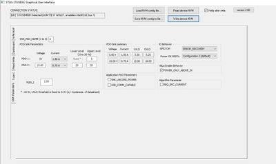

1) Problem related to STSW-STUSB002 GUI version 2.0.
The first problem is with the GUI version 2.0 as specified. When I made hardware connections as mentioned in the quick start document and I tried to connect the Nucleo- F072RB with the GUI 2.0, I got an error which says " The Parameter is Incorrect". and I'm unable to connect the hardware with the GUI 2.0.
I have resolved this issue by using the previous version ( STSW-STUSB002 GUI 1.09 ). So my hardware got detected in this version and I was able to program or write the NVM successfully. In the Connection Status of the GUI 1.09 it showed that " OK STUSB4500_L Detected (COM19), at address 0x28 (I2C bus 1)" sharing image below.

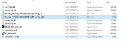

2024-06-05 12:17 AM
The .bin file used is "Nucleo_F072RB_STUSB_UART_NVM_config_1.05" which is provided in the package STSW-STUSB002.

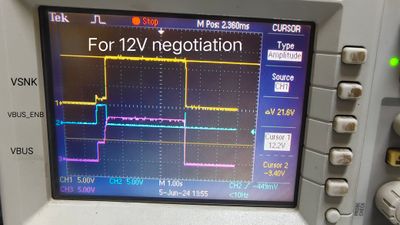

2024-06-05 3:29 AM - edited 2024-06-05 5:48 AM

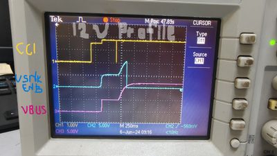

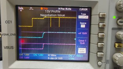

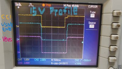

Here are the waveforms,
CHANNEL 1: VSNK (Switched to +12V)
CHANNEL 2: VBUS_ENB (Pulse observed)
CHANNEL 3: VBUS (Initially +5V and after negotiation +12V)
CHANNEL 1: VSNK (Not switched to +15V)
CHANNEL 2: VBUS_ENB (Pulse not observed)
CHANNEL 3: VBUS (Negotiation does not happen)

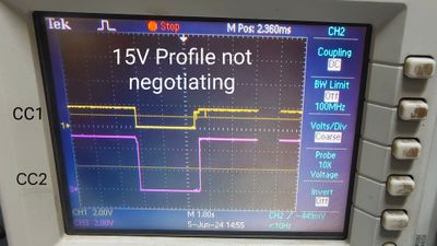

***CC1 AND CC2 SIGNALS

2024-06-05 7:14 AM
Hello
on 15V waveform, it seems that there is no messaging on CC lines.
Can you please provide scope snapshot with 500ms total, trigged on CC rising edge (i.e zoom on first part of CC rising edge)
Thanks
Nathalie

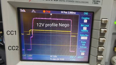

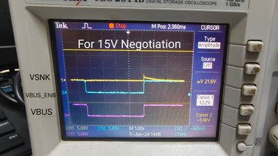

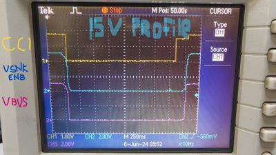

2024-06-05 10:35 PM
Sending you snapshots for 15V 500ms and 250ms triggered on CC rising edge.
Also below is for 12V 250ms snapshot triggered on cc edge
Regards,
Ashutosh Kedare
2024-06-05 10:53 PM
Hello
As you can see, the source which is supposed to negociate 15V is not responsive.
It seems to be a TypeC 5V source only: there is no messaging from source to initiate any contract. While with 12V source, there is clearly an activity on CC line which reflects the power nego.
Issue is on source side.
Best regards
Nathalie

2024-06-06 2:22 AM
I'm able to get the source_cap message but the profile is not switching to 15V.
Regards,
Ashutosh K
2024-06-06 4:26 AM
seems that something has changed in the setup to get CC communication.
however without being able to see messages in protocol trace, it is nearly impossible to debug.
Best reagrds
Nathalie
