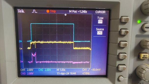

Would it be possible to get some oscilloscope capture of VBUS, Vsink, CC1 & CC2 please ?
I think that the application creates an inrush on power path closure when it is closed the 1st time. 2nd time, application capacitor might be not fully discharge so that inrush is less and it can start.

Here is the oscilloscope capture of issue.
Blue: VBUS = 5V
Yellow: CC2 = Around 2V
Pink: VSNK = 2V spike
In the above case as we could see that the FET is not turning ON. On VBUS there is 5V constant and on VSNK there is just a spike and no voltage where as CC1 is constant around 2V.

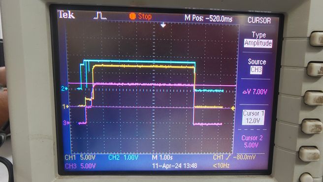

Below is the capture of Normal Condition waveform
Blue: CC2 =1.7V
Yellow: VBUS = 12V
Pink: VSNK = 12V
Please not No Load is connected to the VSNK in both the conditions.

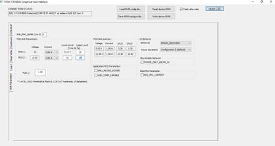

I have surpassed 9V and 12V profiles and in GUI I have set PDO's as given in image below.
I have tried 15V 0.5A, 15V,1A , 15V 1.5A, 15V 2A. But nothing worked. Tried entering current value lesser than source current for 15V and 20V it also doesn't worked.

Please provide the NVM content you used.
Best regards
Nathalie
2024-06-03 6:27 AM
Below is the NVM content I used. I have also tried with PDO 15V, 2A .
2024-06-03 6:32 AM
Looks OK.
